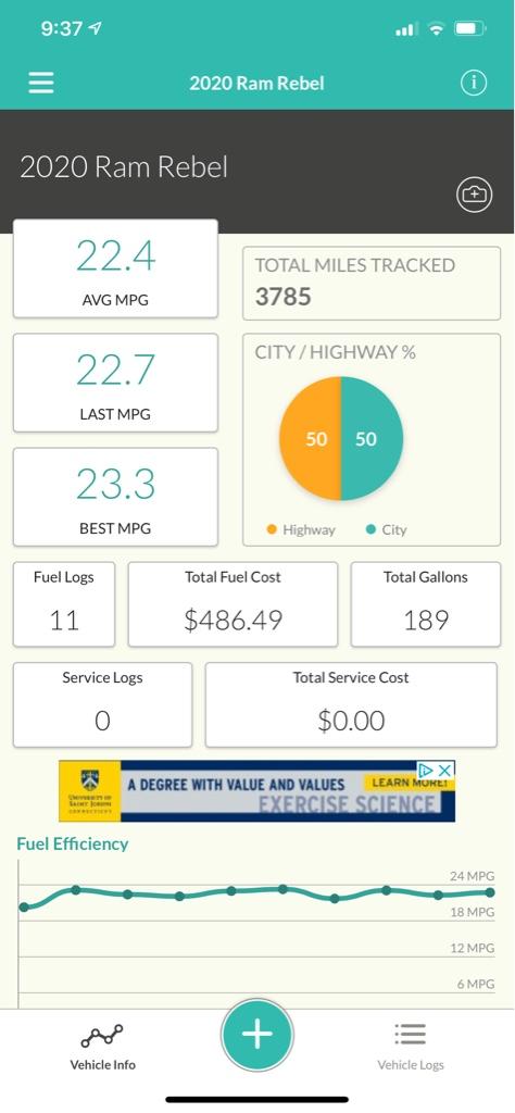

2020 EcoDiesel 3.92 and 4x4, I am right under 600 miles on the truck and my average on the dash is at 22.2 mpg but I have seen it as high as 22.6 mpg. Most of the driving so far has been 40/60 highway and city.

I did did the calculations comparing my 2011 Ram with the 5.7 Hemi and my 2020 Rebel 3L diesel, the calculations are for 16000km (10000 miles) I added the DEF, one $250 oil change (at 16000km) compared to two $75 oil changes for the Hemi (8000km each), I put diesel at $1.00/ litre and $1.10/litre for regular 87 octane gas, diesel is usually cheaper than gas here in Northern Ontario. A total difference of over $800 cheaper to drive my new Rebel for the 16000 km.
Now the top figures are not accurate as what they will be, hopefully over $900 savings, because I purchased the recommended diesel oil 5w40 at half the price and hopefully be buying the OEM oil filter at a discount price. I found the OEM oil filter at Rockauto.com it is cheaper but it’s the older part number #68498720AA, on the mopar.com it says oil filter #68507598AA (supersession #68498720AA), now did the number change or did the filter change? I will have to make some calls before purchasing. Has anyone else ordered these filter?
