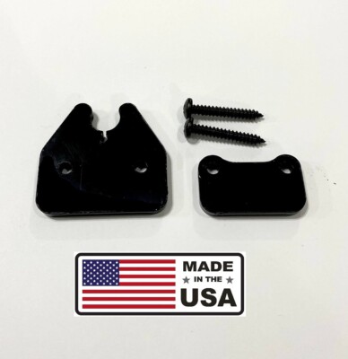

This time the passenger side broke. I bought the Chinese version of the repair kit and installed it today. It works fine and was pretty easy to install with an extra pair of hands to help hold the visor while you get it all lined up to get the screws in.
