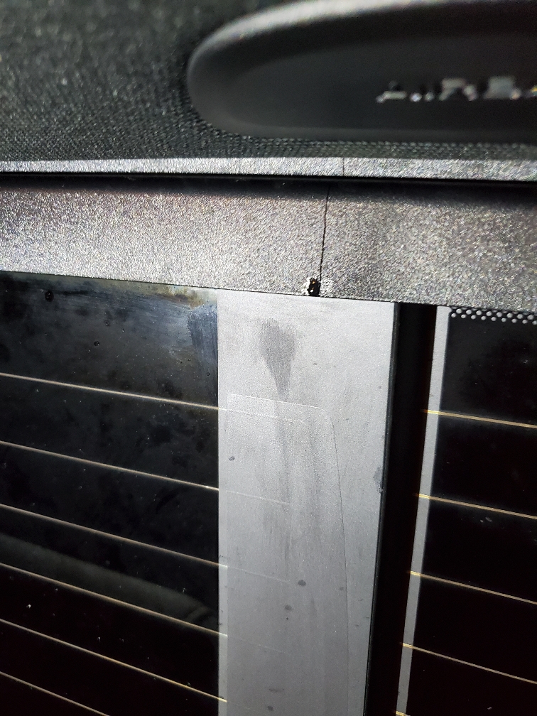

I have seen several Rams on here with this exact same problem. The frame around my rear window cracked and it is now leaking into the cab. Unfortunately, mine didn't show up until now and I have 38k miles on my truck. Am I screwed, or will Ram step up and help me fix this since this is a known problem?

A couple of months ago, someone stated that in 2021 Stellantis sourced a new, more flexible RTV for the rear window. He mentioned that the old RTV dried so hard that when the body twisted, it transferred too much load to the plastic frame, which caused it to crack. I'll see if I can find the post.
This is all I could find: Is there a Service Bulletin for the rear window leak?

Mine isn’t cracked it’s just leaking in from the top right rear. It could very well just be the glass sealant to the body that is leaking. Only diagnosed it so I knew exactly where it was leaking and with the water running only over the corner rear it leaks in.

Yeah, I'd suspect more of an issue with the seal than with the window itself with your leak. Appreciate the pics. (y) The fact that your frame isn't cracked gives me hope that the upgraded rear window might have fixed the issues with cracking.
