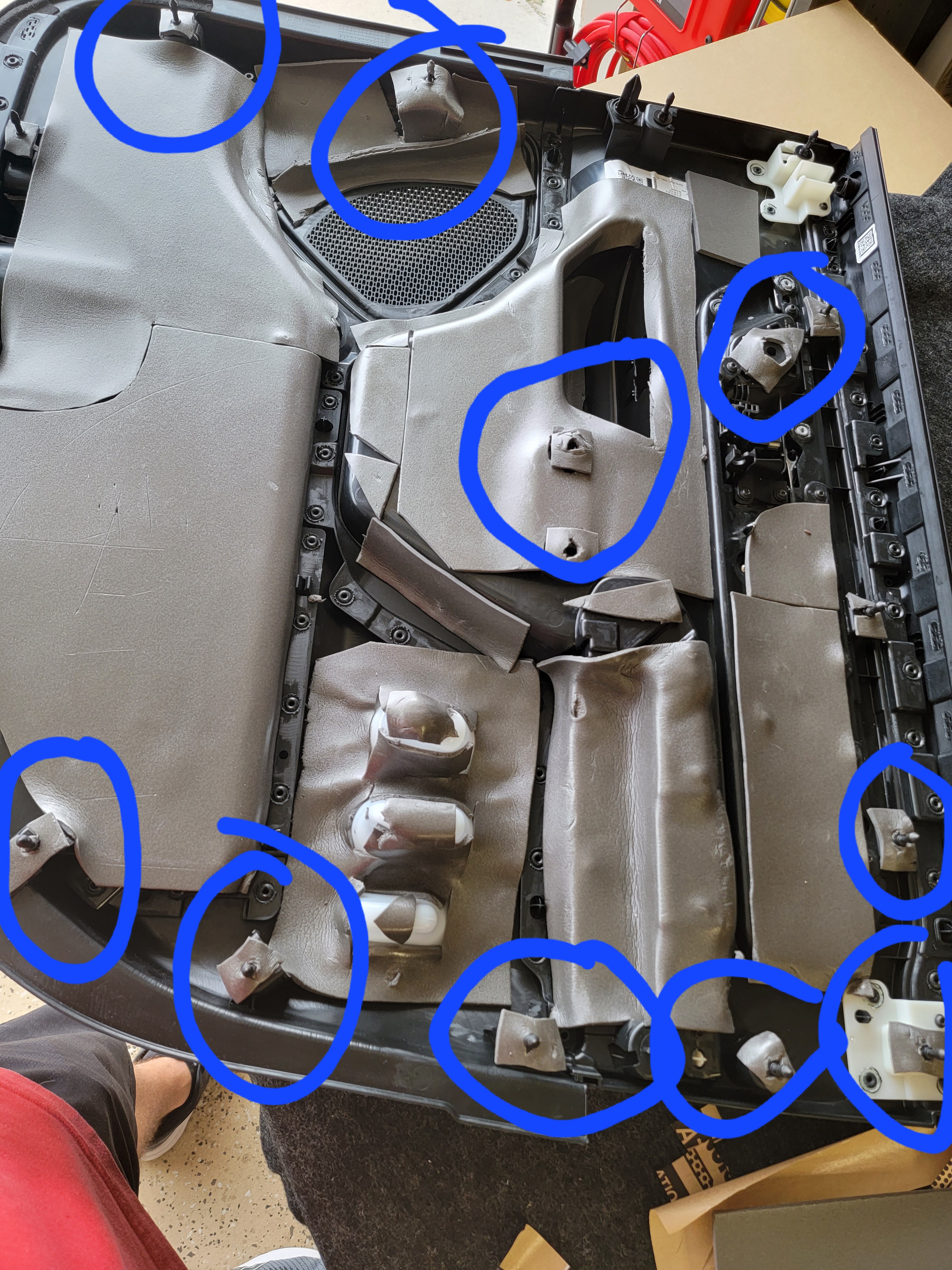

Most dealers are going to suck at finding and fixing rattles. There is little to no money in it for them as they have to get paid by the manufacture for the work they perform and to do it properly it can be time consuming. I can't stand even the slightest of squeaks or rattles, so I have removed all 4 door panels and used stinger roadkill professional and applied it to the backside of all of the interior door panels. there are several spots that tend to rattle because of the way they are designed an assembled. What area of the door is the rattle coming from? The areas in red all have road kill, the box in green has 1/4" thick adhesive back foam strips behind it. The biggest source of rattles for me is the big rectangle from the door handle back. The section is made of numerous parts that are basically heat welded together. The would only ratle during bass heavy music but that was unacceptable so now its roadkilled and silent no matter what the speaker is doing.

They are held on there pretty well so getting the first clips loose takes a bit of force to the point you think something is going to break but it doesn't. I have attached the Factory guide, I have also added notes in red from my experience to help along the way if you choose to go down this road.

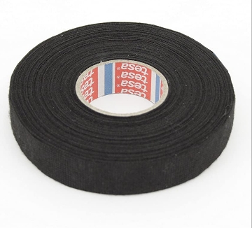

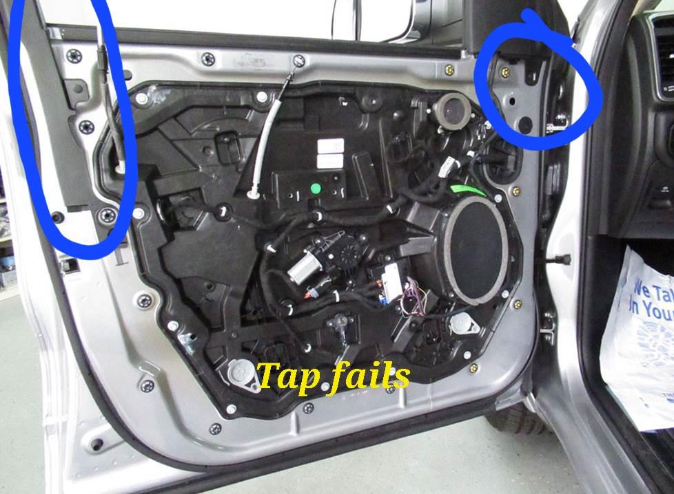

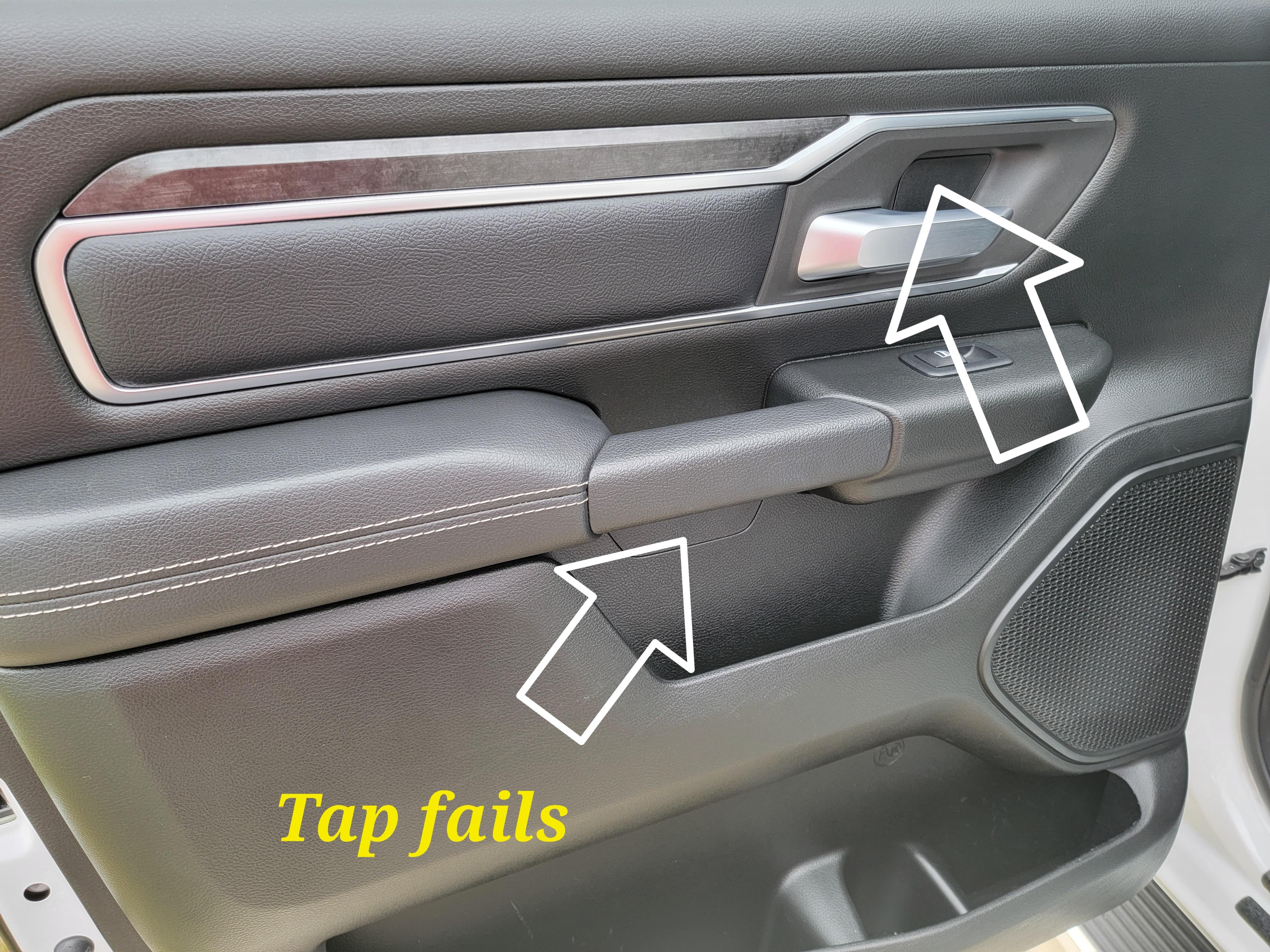

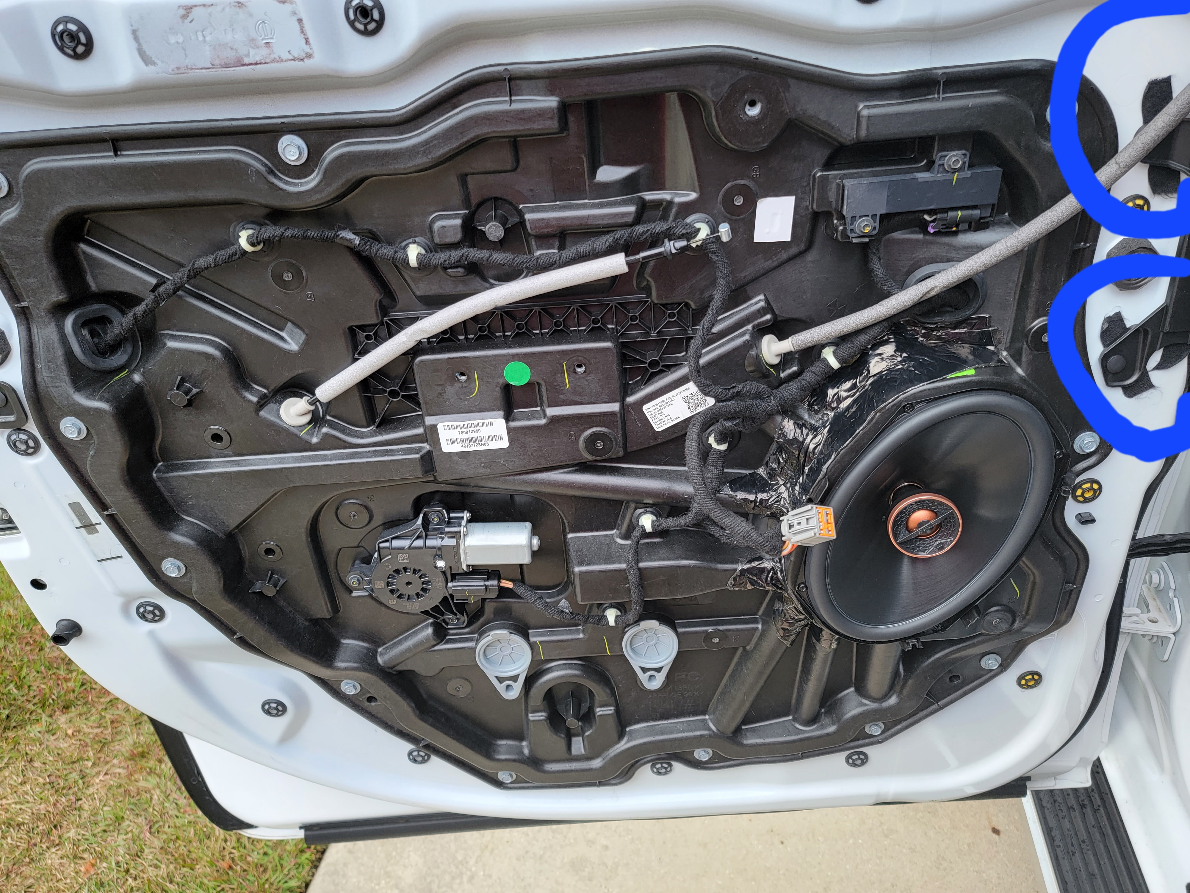

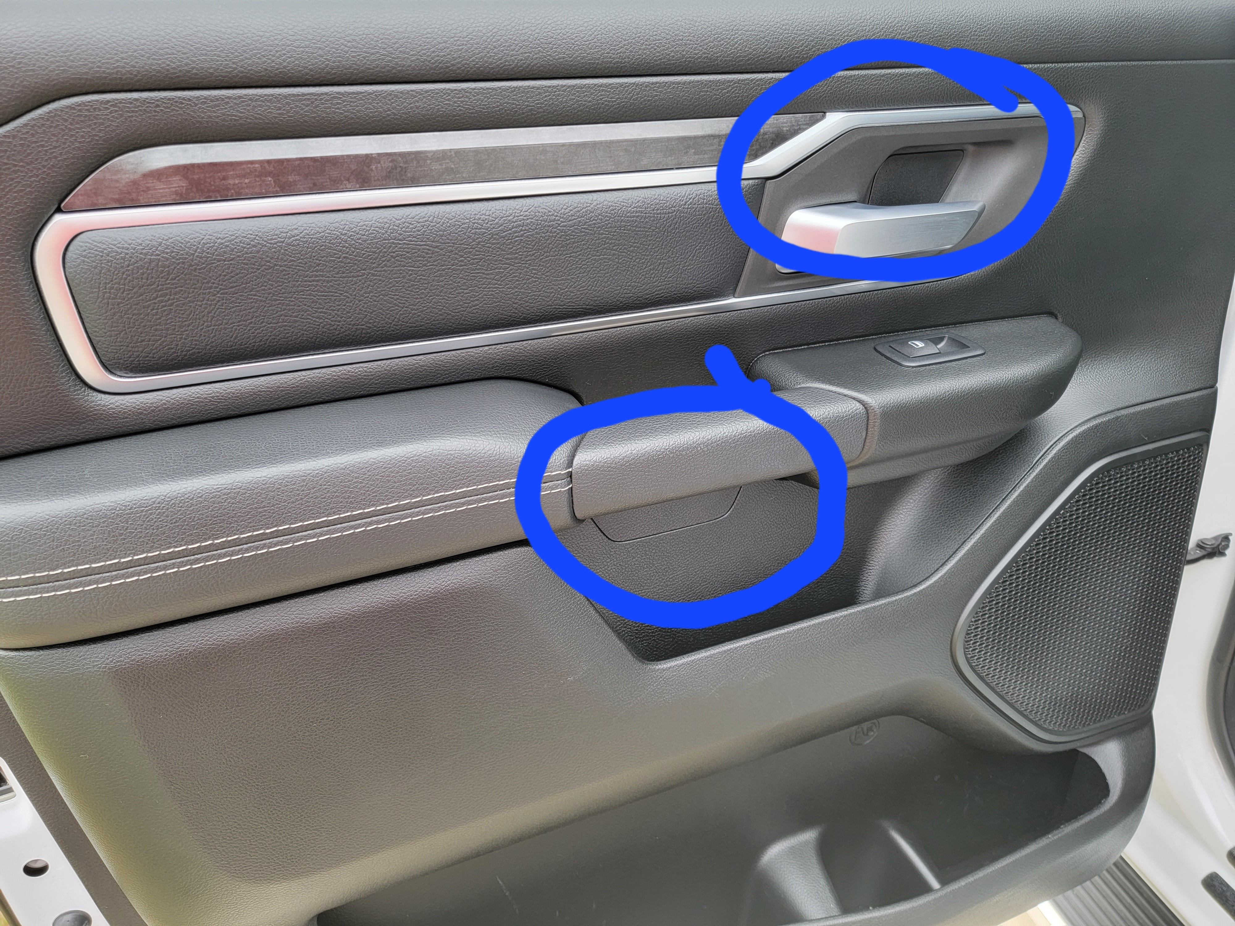

Maybe excessive, but I can't stand rattles and love sound quality.
Crank up the jams and start putting pressure on various points. The two removable bolt covers (under the grab handle and behind the door open latch) are prone to vibrate. I put tessa tape behind those and anywhere plastic touched metal, especially up by the mirror.
Also added foam sound deadening foam on every door panel fastener.

When I take the panels off to do sound deadening in vehicles, I always do a tap test to see where I need to do additional/preventative deading or separation using foam, tessa tape, or butyl mat. These are the trouble spots I found in these doors. Kinda already mentioned above. The window switches are culprits too, but mine were pretty snug and are not making any noise.
The dealer is never going to spend the time you will on trying to hunt noises down.
Also, find a subwoofer frequency playlist on spotify etc. Don't go crazy loud, maybe start around 60-80hz and work your way up.
Once you get the rattle, press on the panel in various spots to try and kill it. You'll know where you need to go from there.
