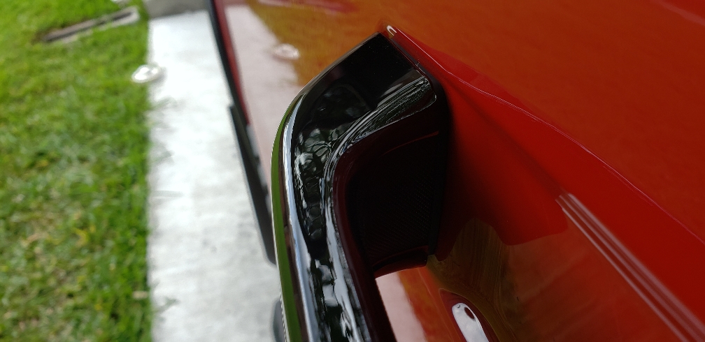

Awesome, thanks for taking additional pics. Looks good.
I may look into the black handles vs the color match. Had that on my last truck.
I have the passive entry though and I"m not sure if that makes it more complicated or more expensive.

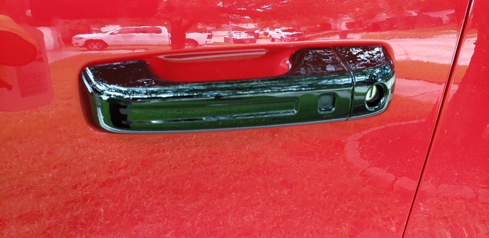

I got them installed a few days ago. I did have to cut out a little black vinyl to go around the lock buttons, because the openings are a little off.
asylvest
May 23, 2020
6
6
Those look great, and I am a big fan of the black on red. Nicely done and thanks for posting the pictures
