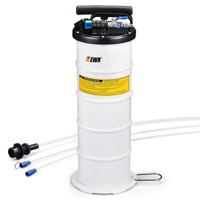

My Range Rover has a very similar setup with the paper filter canister on top too. I purchased this tool to make my own oil changes. I never got to use it. After watching you-tube videos on it I was sold. I'm planning to use this on my Ram. With this I won't have to crawl under the truck.

I would get a little dirty and look at your drain plug first. I can reach it pretty easy without jacking up my truck. I plan to get an extractor something like that but I will use it only for my outboard boat motor. I don't have a trailer for the boat so the extractor is the only way to change the oil. A lot of people seem to like extractors but when I can I pull the plug. On my convertible that means jacking or driving up on ramps.

For the guy who wants to use an extractor I would say you need to be very patient. I used one on my pontoons motor, a 90hp Mercury, and it took a couple hours for it to get the oil out. It is 25/40W, so thicker, but I would think it would still take an hour for an extractor to remover the oil from one of our trucks. But it worked well on my outboard - which was in the lake or I would have done it conventionally too.
