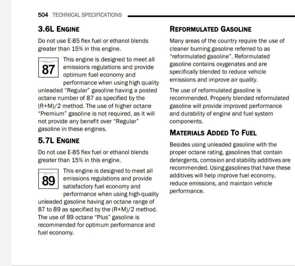

With the Hemi, you need to run 87 octane or higher.
Sorry I was just following the instruction book. I’ll listen to you now.

I believe they mention 87 because at altitude they sell mid-grade at 87 since the altitude also resists pre-detonation. They clarify this with the sentence directly after by describing it as "Plus" which to me indicates mid-grade for the relative altitude of your region.
Obviously many people use regular in their Hemi, but there is also plenty of people reporting knocking until the system retards the timing when towing heavy loads with regular. I think the manual clearly is indicating that mid-grade is preferred for the hemi.
No I’m gonna listen to that guy with the blue sharpie.
Even though the one tank of 87 I used while towing lead to the timing retarding to the point that the truck couldn’t get out of 5th gear when it’s otherwise always in 7th or 8th and used around 25% more gas, and also I spent $90k on a truck and am too cheap to spend an extra $10 per tank so it doesn’t knock…I’m gonna listen to blue sharpie guy.
