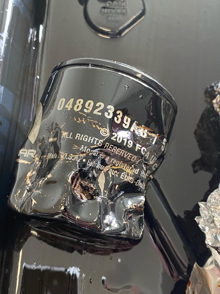

I did mine a couple weeks ago at 5000 miles. Factory filter was very tight, same on all 3 new rams I've had going back to 1988. I thought I was set because my son had a socket that fit my new NAPA (wix) filter but it didn't fit the factory filter!! I had to break out the redneck strap wrench that I made out of a nylon strap and a piece of pipe back in 88 to get that one off after I drove a screwdriver through the filter and ripped the bottom of the filter off. At that point I was committed!

Did my first oil change a couple of weeks ago too. This was the aftermath of removing filter.
Yup, I think that's everyone's fear doing the first change on these RAMs. By chance, what oil temp where you at when you did the oil change?
