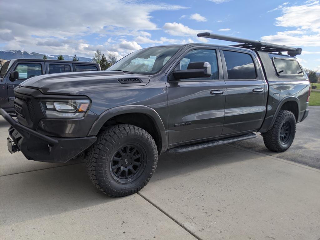

So I have roughly 2.25-2.5” of rake. Measuring from the ground (w/ 33” tires): F-38 7/8” / R- 40 3/8” or measuring from the center of hub F-22.5” / R-24.75”

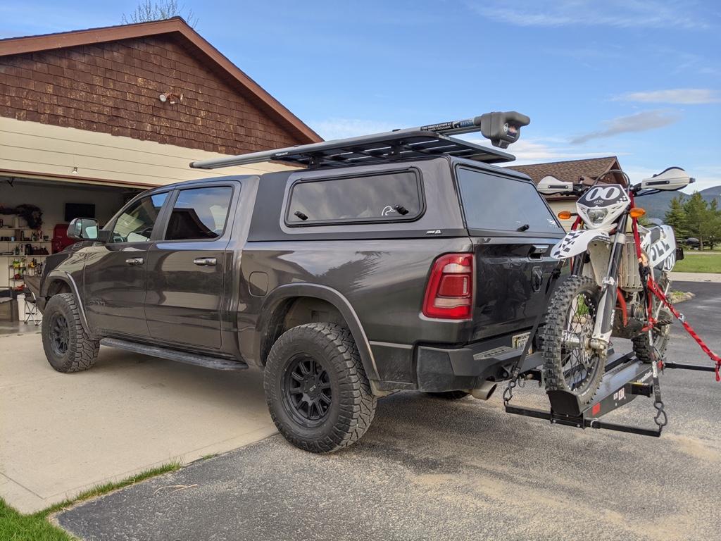

Yep, it is a Laramie with ORP to which I then added the Mopar lift. It wasn’t the updated one but I did take it back and have them add the part. I don’t recall if it was before or after this photo but I believe it was before.
Since then I have added airlift airbags on the back so it doesn’t sag with my motorcycle on the back and increased the tire size to 35”
Here’s one more image from the front.

Thanks! Keep in mind that I have Fab Fours bumper, a Warn winch and a light bar so there is some extra weight out there. That being said, I am super happy with how it all turned out.
