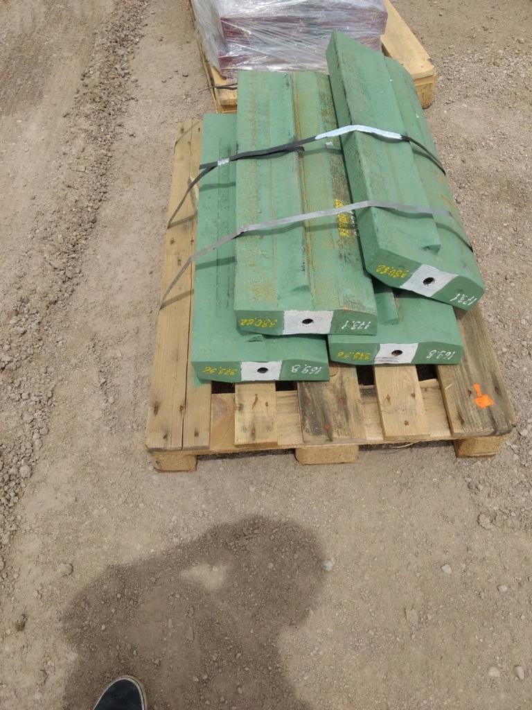

That sounds like an awesome set up. I’m debating my options on my 2020 Laramie 4x4 without ORP right now too. I’m planning on doing the same up front, 5100 on 4 or 5 setting. I’ll have a better idea once I get my roll top and everything installed in my bed. Looking to keep just a bit of front end rake with stock height on rear. While I don’t haul a trailer that often I do often carry around 1,000 pounds of steel in the bed (replacement hammers for my rock crusher). I’m leaning towards either doing the Airlift 1000s or 5000s.
Here’s a picture of the lovely pieces of expensive steel I carry often.
