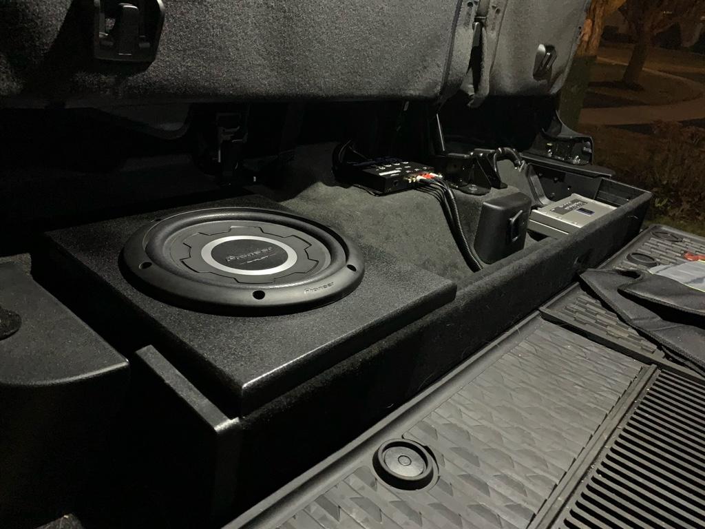

I built a 10” box to fit in the Ram storage bin. I don’t see why you couldn’t build a second to fit in the other side.

Ugh...exploring boxes for my new crew cab and all I see are these fugly low effort sub boxes that stick out from the seats and cover the floor bins. Looks so trashy and cheap...
Time to bite the bullet on the stealth JL :( as it seems to be the only option unless you want that eye sore of a fox box sitting in the back circa 1994. The only good looking box was a user made one by @Waterfowler41 that puts all these others to shame.
he helped me make mine from his spec's (y)
