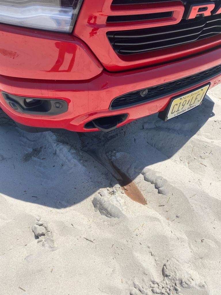

Fun time yesterday! Was on the beach, driving in some soft sand, got the check engine, then overheating warning light. Parked the truck and truck was smoking, and coolant pouring out all over the beach. code says cooling fan control circuit failed. Luckily I had enough water to get fill the tank and get off the beach an back home! Def was not a good feeling on a fairly new truck, especially when a beach tow is big $$$.

Where was the coolent pouring out of? I’d be pissed too being a new truck.

It seems like it boiled up and came out the overflow. Not sure how much I lost honestly because the sand absorbed it.
