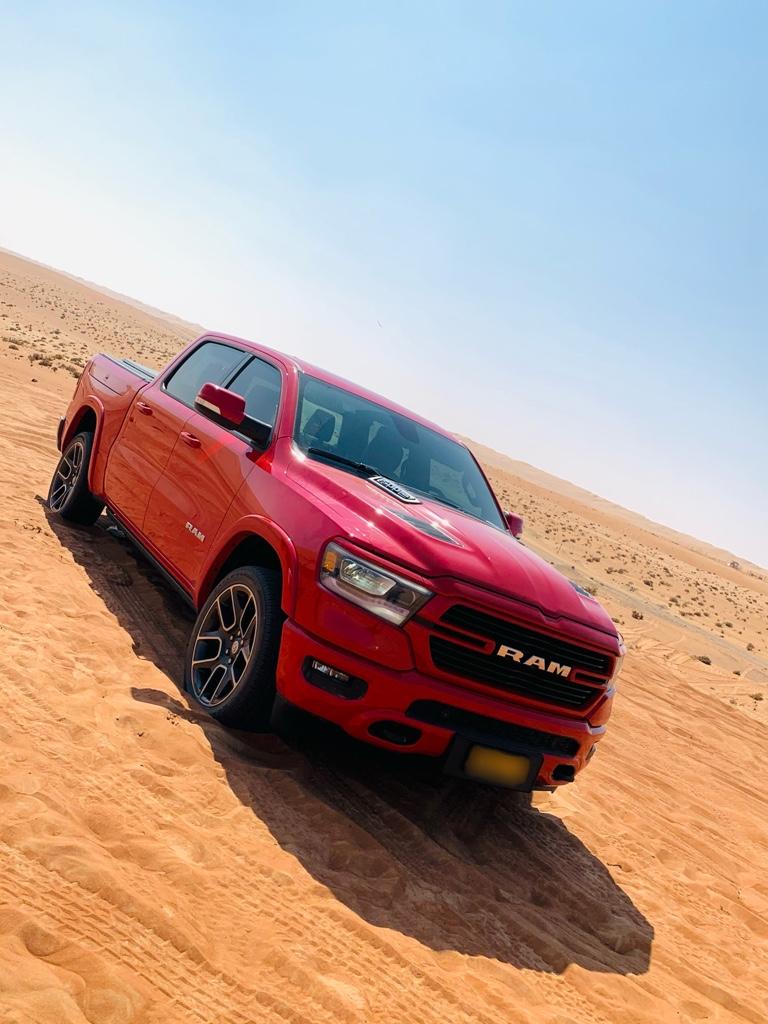

I have purchased 2020 RAM Laramie 1500 sport,
But was surprised that it has a conventional differential.
Can i change it to locking differential? Either LSD or mechanical lock!!
