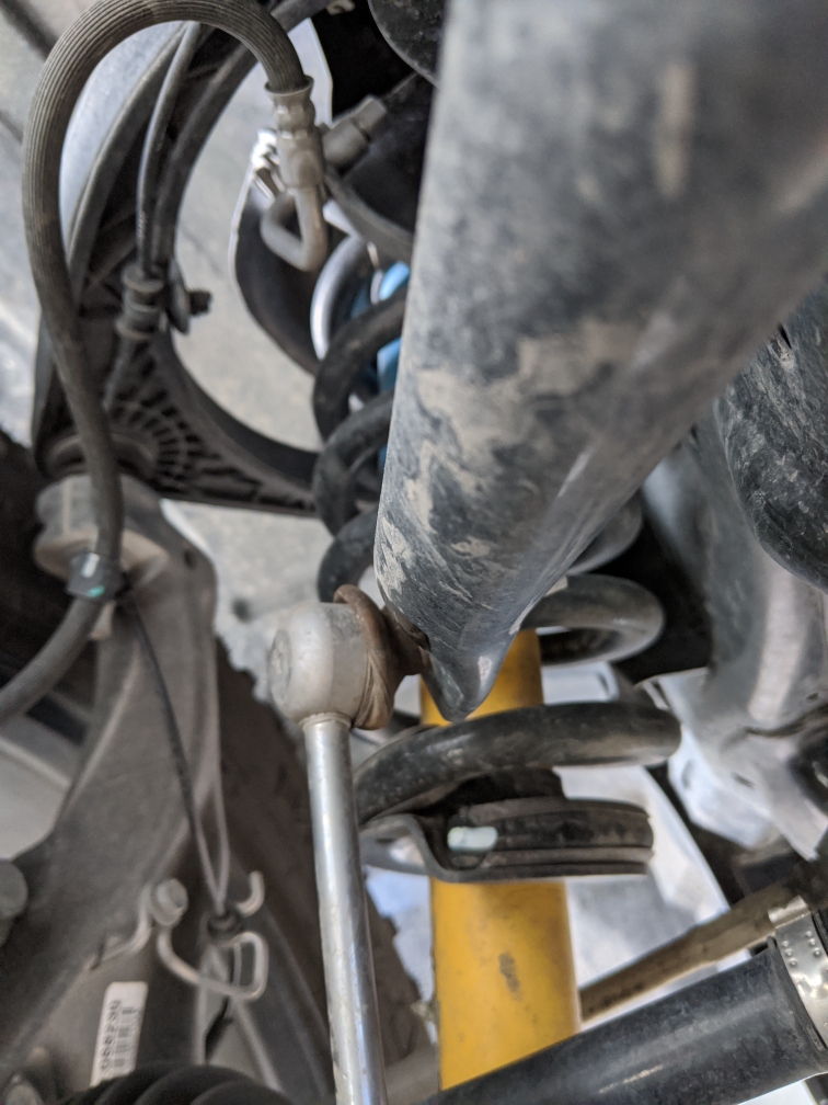

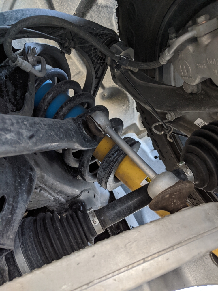

For whatever it’s worth, my June 2019 build Laramie needed new swaybar links for a clunking sound. They old ones were tight but defective. It was most noticeable at lower speeds on washboard pavement.
Do you mind posting pictures of your end links? I don't think mine look right and I get clunking when going over bumps occasionally.
Sent from my Pixel 2 XL using Tapatalk
Sure thing. I’ll snap some when I get some daylight and better than the current weather.

Thanks. I took pictures of mine and posted. It looks like the rubber boot is coming off.
it’s under post “looking for noise in front end and found this”
I have pictures of my links on that post
Here are a few snaps from each side of the front. I can’t really see the difference between the newer, good links and what was there though. However, I have no more clunking sound.

Pretty similar to mine, did they say what exactly was defective about it?

They didn’t really say what was defective. They further tightened the old ones but that didn’t work on their road test. They had new links in stock and after replacing the old links, the clunk went away. If I had to guess, there may have been some issue with how the old ones fit - maybe there was some play in the fitting.
Also, I’ve driven a few thousand miles since the fix and all has been good since.

Thanks for posting those pictures. I'll take a closer look at mine and see if maybe there is some play.
