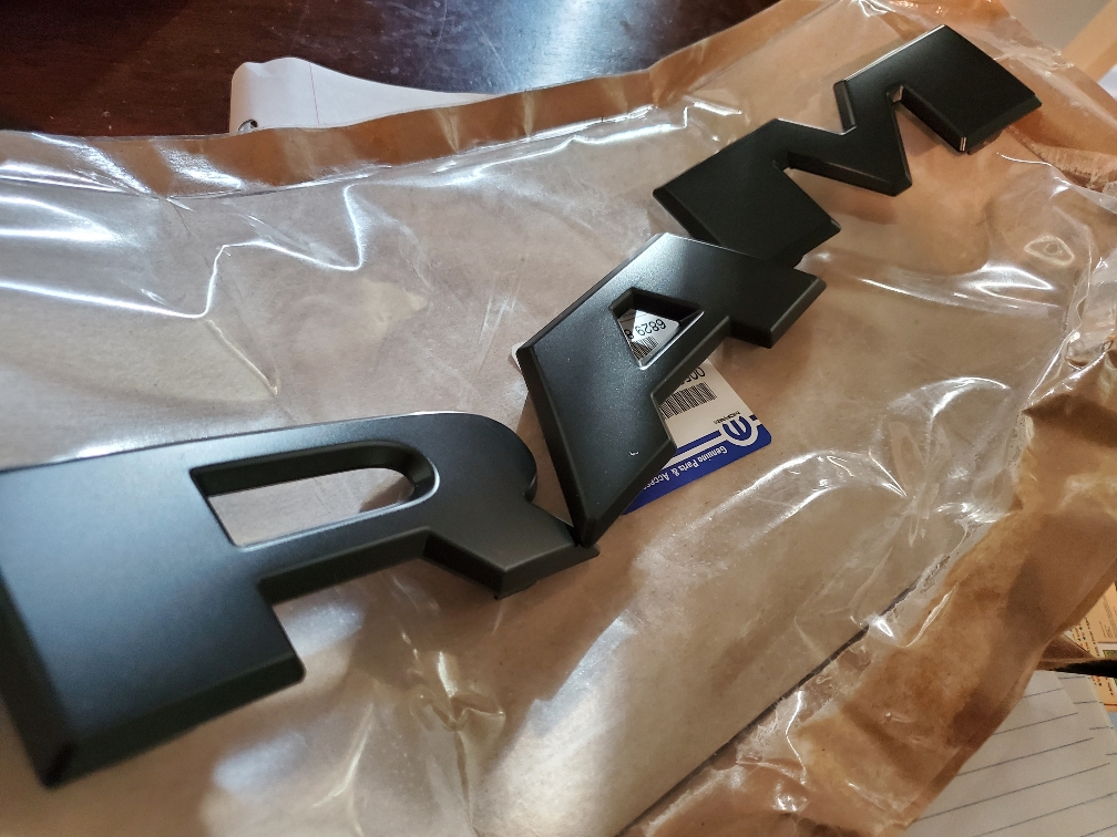

1. Front RAM letters. Ordered Black letters and color match decals
Easy to remove the letters, small flat head screwdriver and just pry out. Don't be afraid to use force, you will break the clips, but you won't need them anyway. Stick vinyl on black letters before putting them into the grille. Done. Takes about 10-15 minutes.
