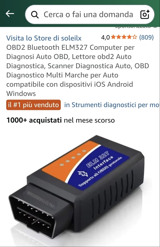

I have already installed on my smartphone Android the app "EOBD simple scan" (I have seen that there is also a PRO version that can erase errors).
For my yamaha yzF I have an ELM327 interface (*) that connects by BlueT but because of my "zero experience" I'd never used it for any modification.
I'll try soon to make a connection with Ram Hurricane to see what happens.

(*) this:

(*) this:
That elm327 will work fine to read codes.
