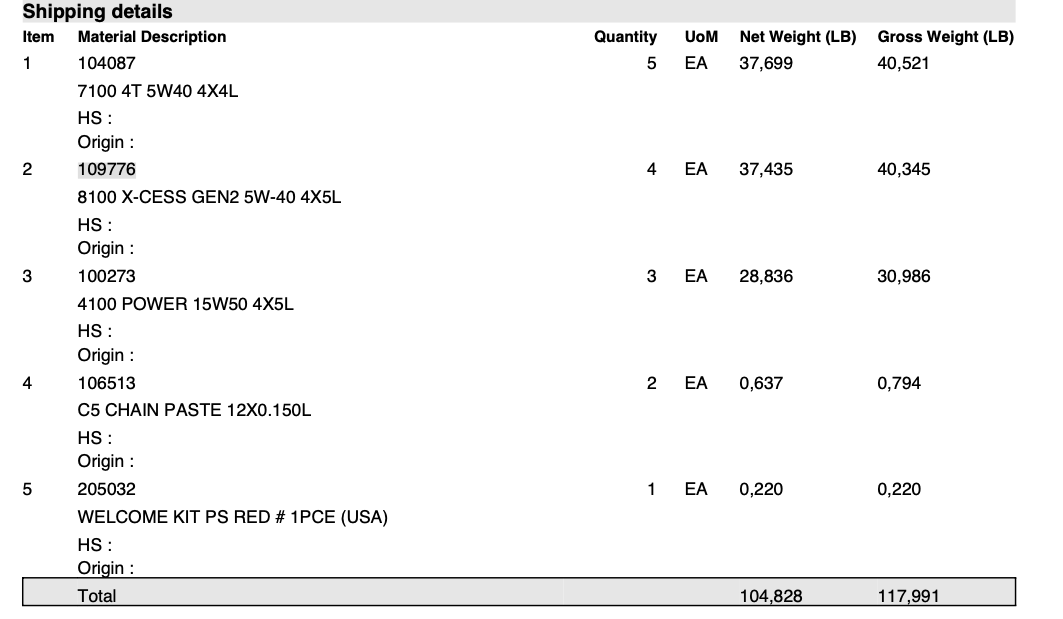

Here's my order sheet from Motul:
download
2nd item is the oil in question which is item - 109776
If I google search for that, I get this page - https://www.motul.com/ca/en/products/8100-x-cess-gen2-5w-40

109776 IS MS-12991 compatible.
Move along people. nothing to see here. I wish MOtul had just put 12991 on my bottle so I didn't have to search the internet for half an hour.
