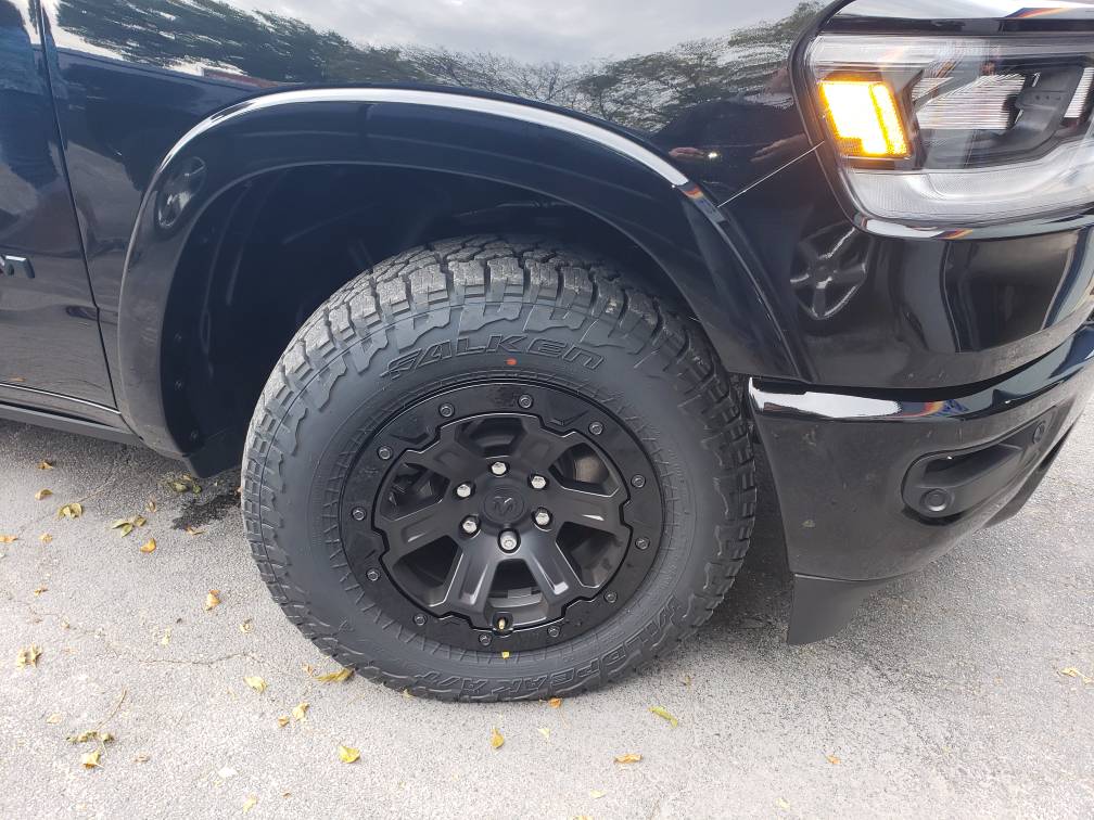

How is the noise level with the Falkens? Higher or lower than the Bridgestone?
Ended upgrading myself to the Falken Wildpeak A/T3W’s thanks in part to @ColoradoCub. No discernible difference in road noise from stock, although I had the Goodyear Fortitude’s not the Bridgestone’s. It is a little bit stiffer of a ride as expected with all terrain tires, although that’s what I tend to prefer. Goodyear’s were too soft of a ride in my opinion. Very happy with the purchase.

Bay Area, CA
I went from 275/65R18 (32") to 275/60R20 (33") with no rubbing on stock coil suspension. I lost 1-1.5 mpg with the 1" diameter increase, but I also am driving the V6 so I cannot testify for those driving the V8. When selecting your tire, pay attention to the load rating and weight of the tire. You will lose more mpg with LT tires because in some cases they are 10lbs heavier per tire than XL or P rated tires.
With my tire swap, I lost 0.5" of sidewall and my drive is now less cushiony, but I also believe the driving experience on the stock 275/65R18's was too soft to begin with. That being said, if you are going from 275/55R20 to 275/60R20, you will be gaining an extra 0.5" of sidewall and your ride should be softer, although you may not be able to notice a significant difference. You can get a visual representation when comparing tire sizes using this tool: https://tiresize.com/comparison/
Road noise will depend on what tire you get. A few models that I have read good user experiences for low road noise are Nitto Ridge Grappler, Hankook Dynapro AT2, Toyo Open Country AT2, Cooper Discoverer AT3 4S, BFGoodrich KO2 and Falken Wildpeak A/T3W.

What brand and type of tire did you switch to in the 275/60R20??? Was it a P rated tire and if so what brand, etc. Thanks so much for the input.
As long as you're not towing anything heavy, I would suggest staying within the SL/XL categories (115T-116T). I went with the Falken Wildpeak A/T3W SL (115T) because the rated revolutions/mile and tire weights weren't as far off from my stock Goodyear's. Looks like you're driving the V8, so you don't so much have to worry about that. Had I been driving the V8, I would have gone with the 275/60R20 Nitto Ridge Grappler XL (116T) based off others satisfaction. But make sure they fall within your budget. The Nitto Ridge Grappler's can be $200 more expensive when you buy a set of 4. If you find the Nitto Ridge Grappler's too expensive, I would recommend the Falken Wildpeak A/T3W or the Hankook Dynapro AT2 in the 275/60R20 size.

I just upgraded from the stock duellers in 275/55/20 to the Falken Wildpeak AT3W in 275/60/20 and the ride is sooo good. I haven’t noticed a drop in my fuel mileage and the motor is running slightly lower rpms at 70. I’m happy
