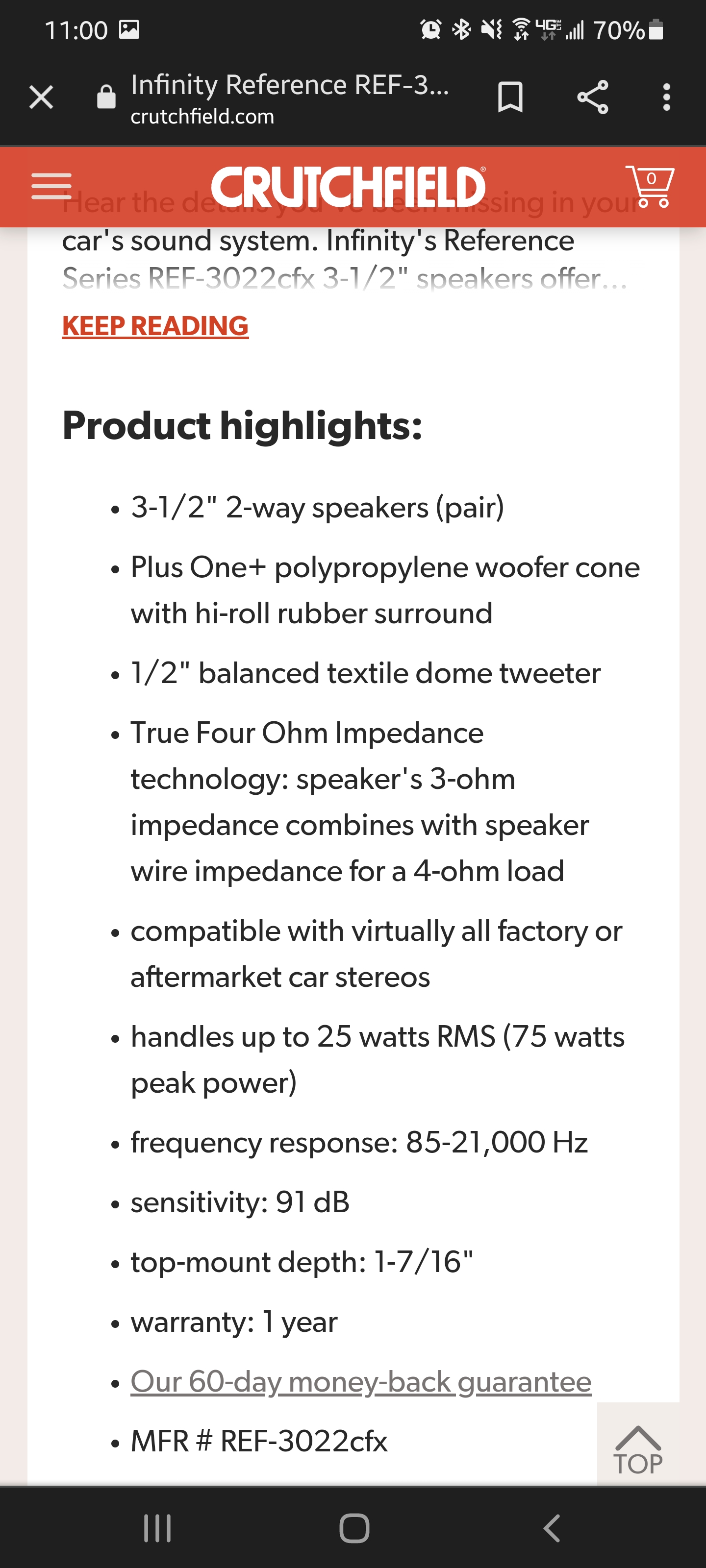

I talked to CDT Audio today about swapping out the center channel on my Alpine system to one of their 3” speakers. They suggested the ES-03DVC, which (on paper) looks like a great solution. The only thing they couldn’t tell me was whether the depth of the speaker fits the space in the dash. Below are the mounting specs and a link. Does anybody know if this speaker will work without cutting brackets in the dash because of the depth?
Specs:
  • Mounting depth: 1.69”(43mm)
  • Cut-out diameter: 2.90” (73.7mm)
  • Cast frame: OD 3.70” (94mm)
They are about the same depth as the infinity (36.5mm) that for sure fit, so I don't see why not.
