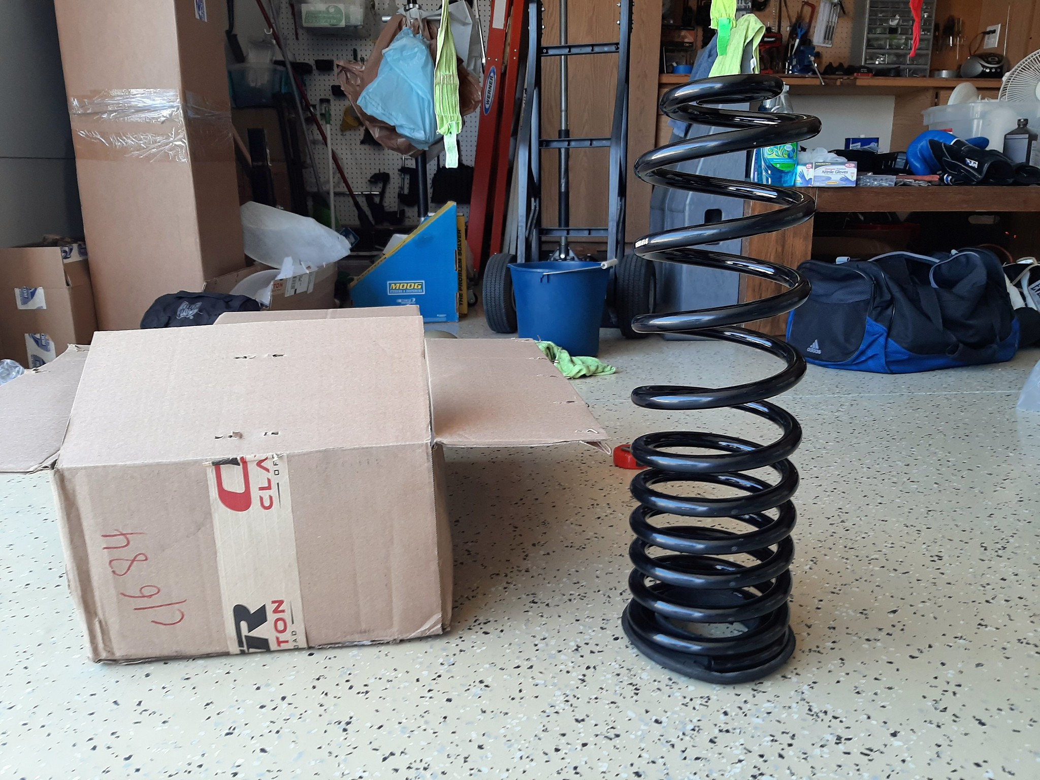

Since you guys can run 4th gen 1500 rear coils springs you could try Clayton 2.5" rear coils, part# COR-1510251
These are springs designed for the 2020 Jeep Gladiator. I'm running them in my RAM 1500 truck because our aftermarket sucks when it comes to mods for overlanding/offroad so i'm always looking/thinking outside of the box
I understand Icon 1.5" springs will in theory provide .5" lift over the ORP springs per another post, if thats the case, Claytons should provide at least rear 1-1.5" lift on top of the ORP's

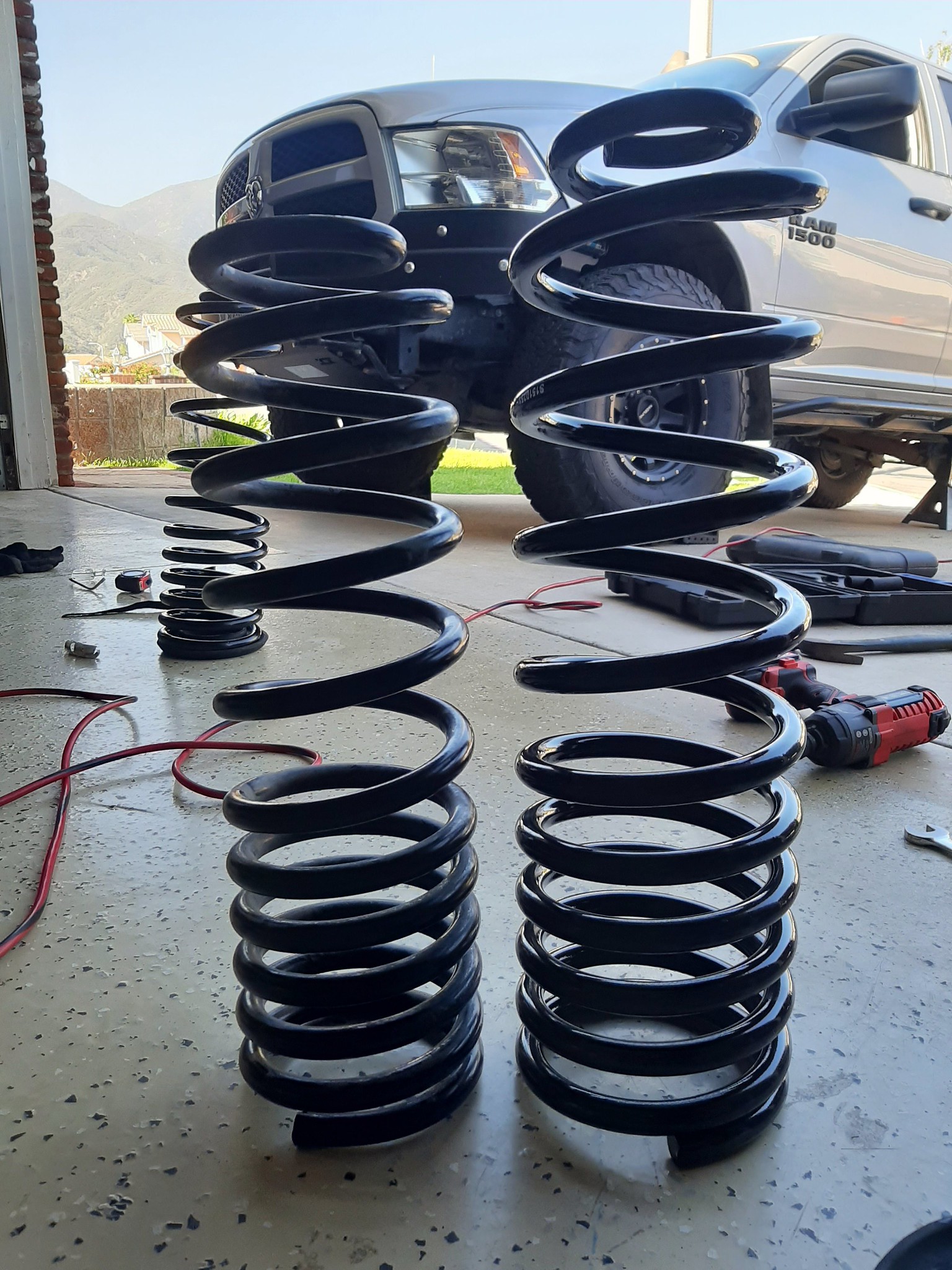

Clayton side by side with the Icons (Claytons are 21.5 in lenght vs 19.5" for the Icons)

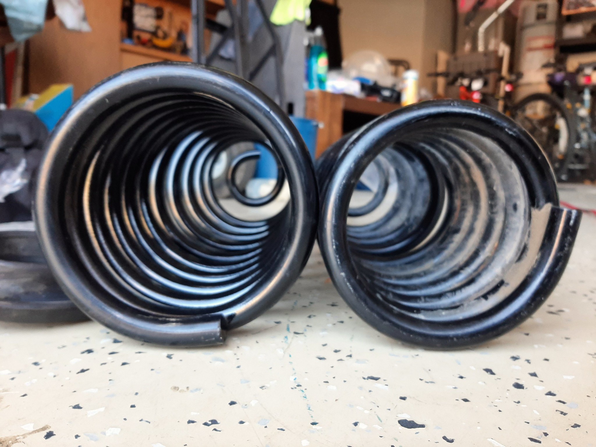

Clayton's lower coil opening where the coil will fit in the lower perch is literally the same as Icon, upper is a tad wider, but it fits the 4th gen RAM 1500 isolator and it also fits in the upper perch. it's a tight fit but there is zero interference with the upper seat

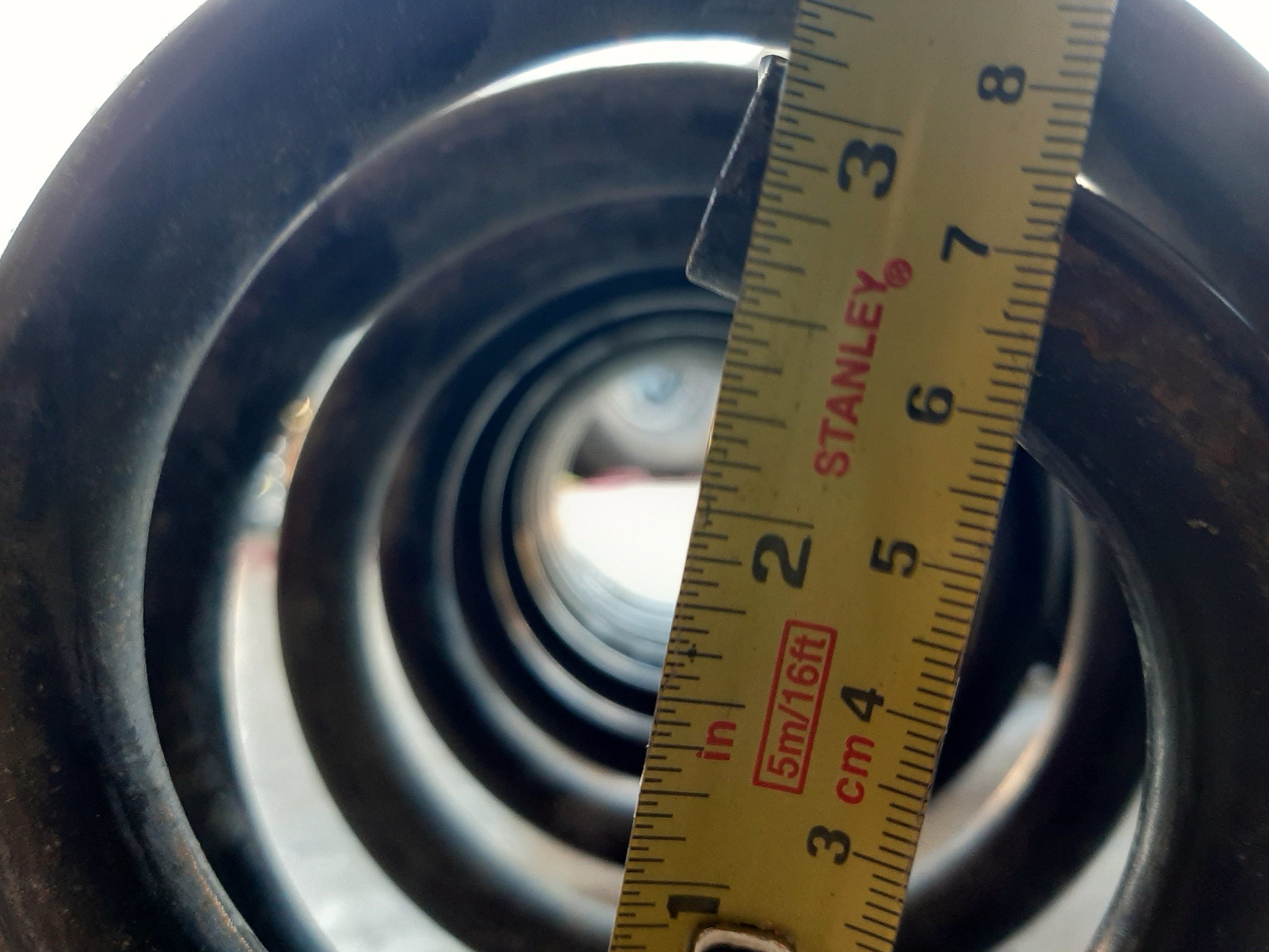

Icon lower coil opening, 2.5"
2020-05-01_08-39-34 by
RAM RSM, on Flickr

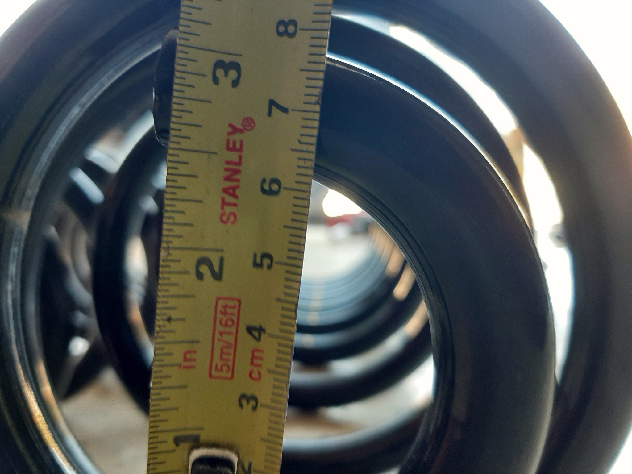

Clayton lower coil opening, 2.5"
2020-05-01_08-39-24 by
RAM RSM, on Flickr

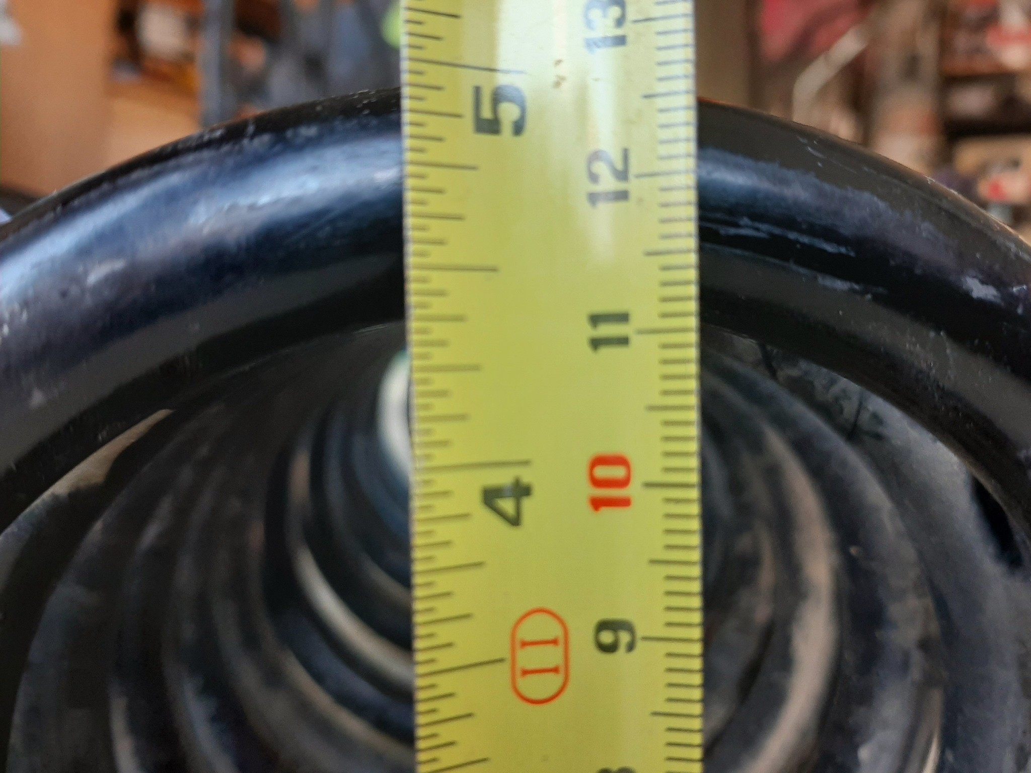

Icon upper coil opening, 4.5"

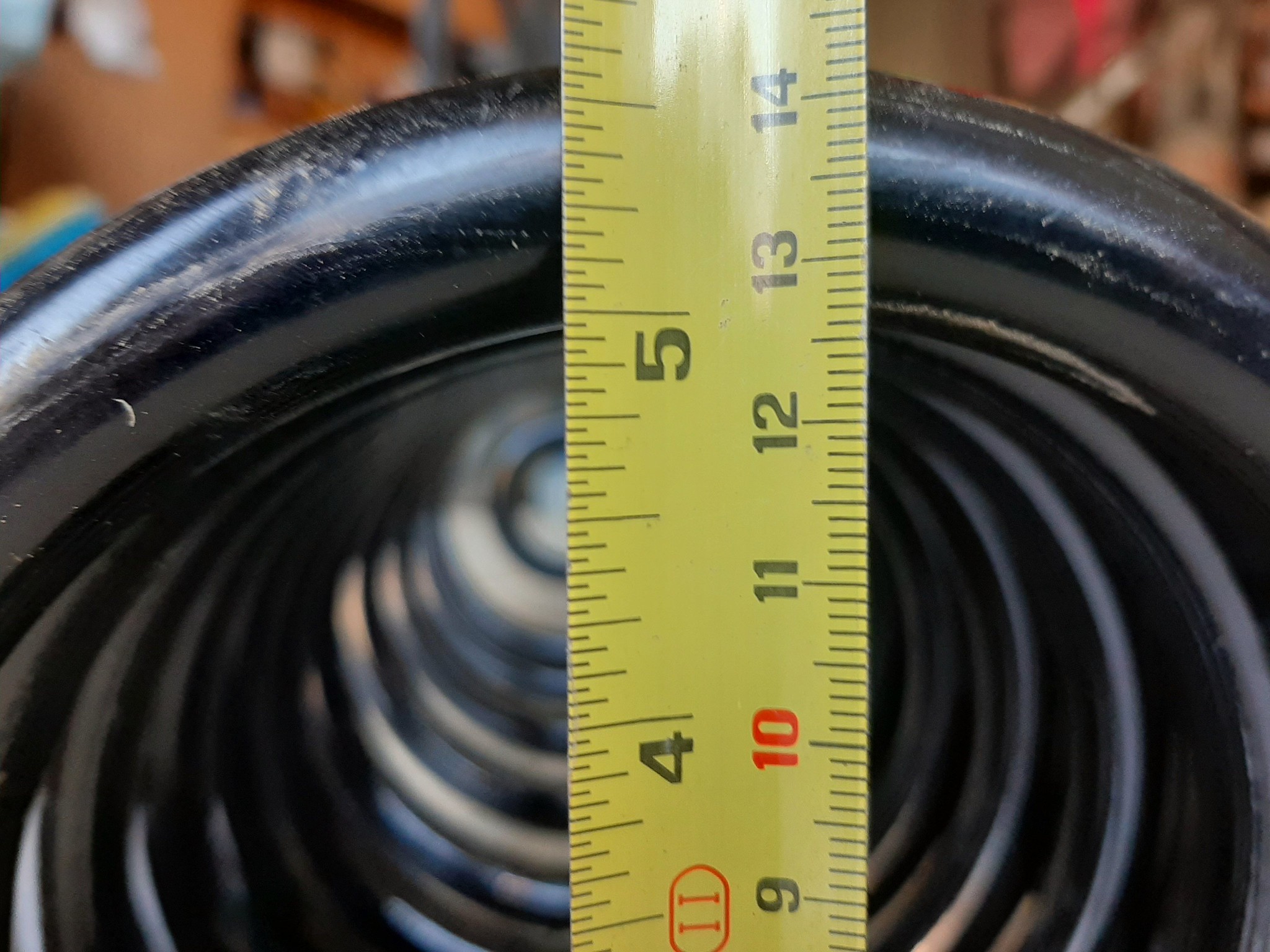

Clayton upper openning, 5"
2020-05-01_08-38-55 by
RAM RSM, on Flickr

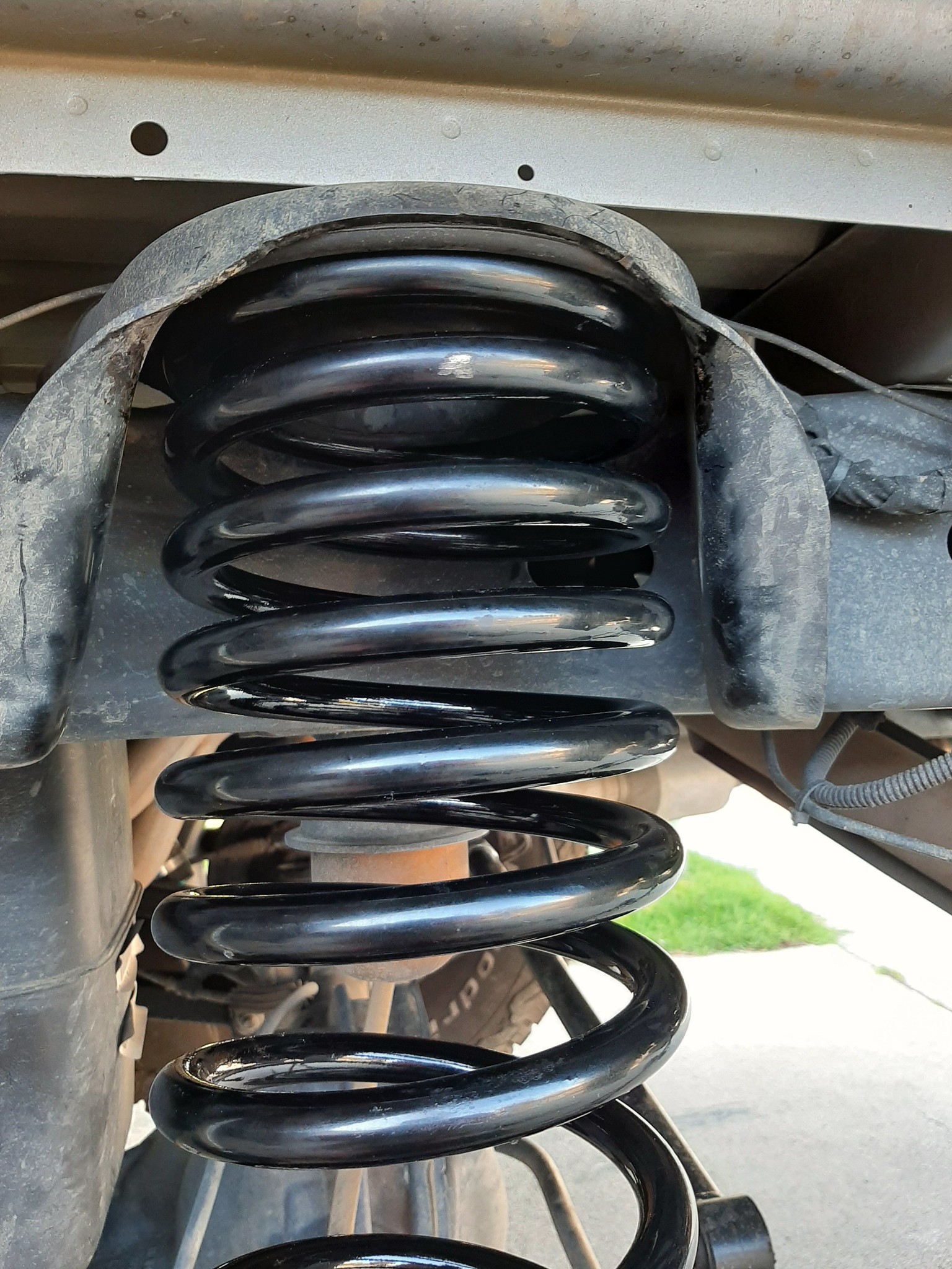

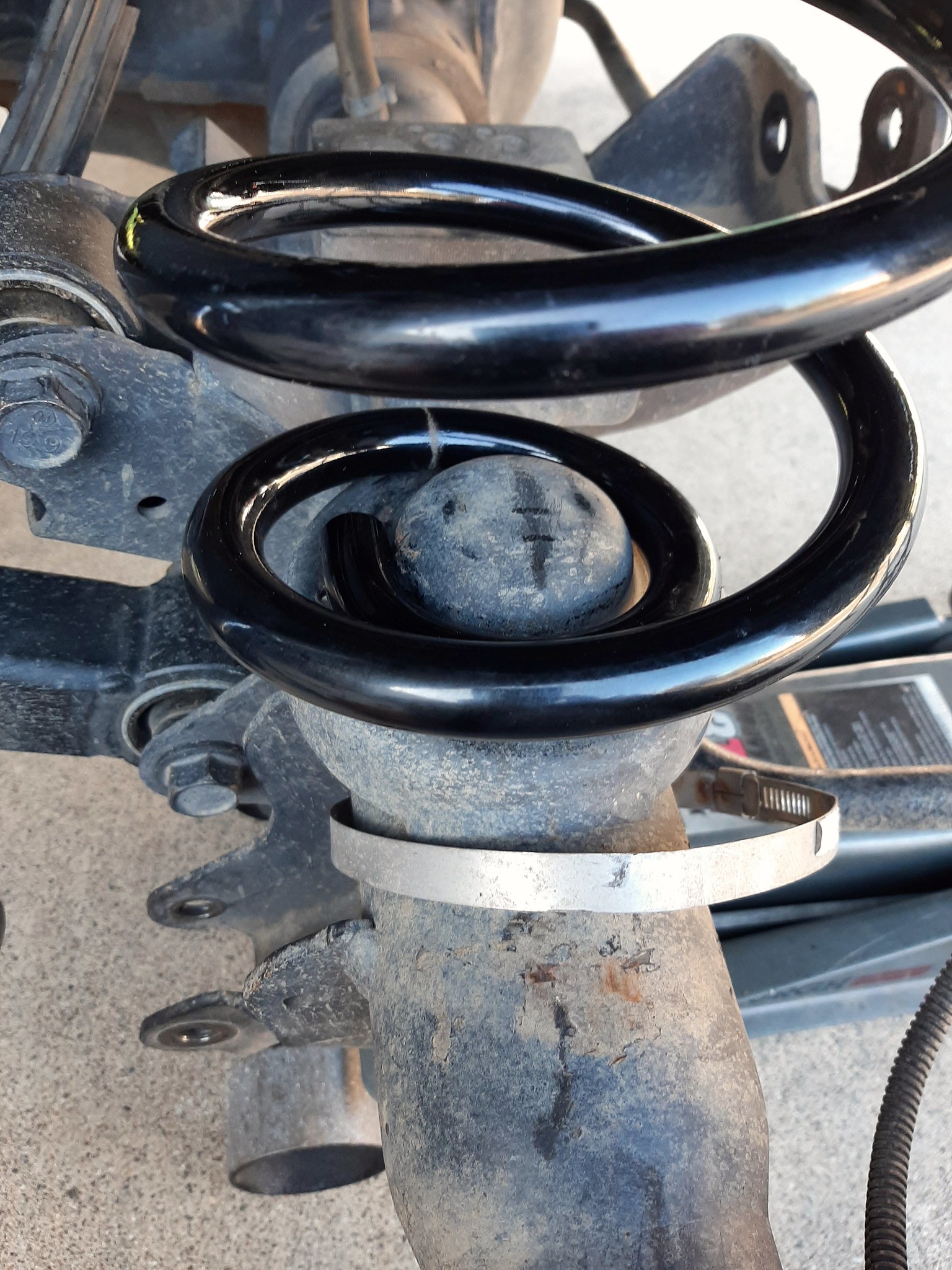

Clayton fitting the lower perch
2020-05-01_08-40-44 by
RAM RSM, on Flickr

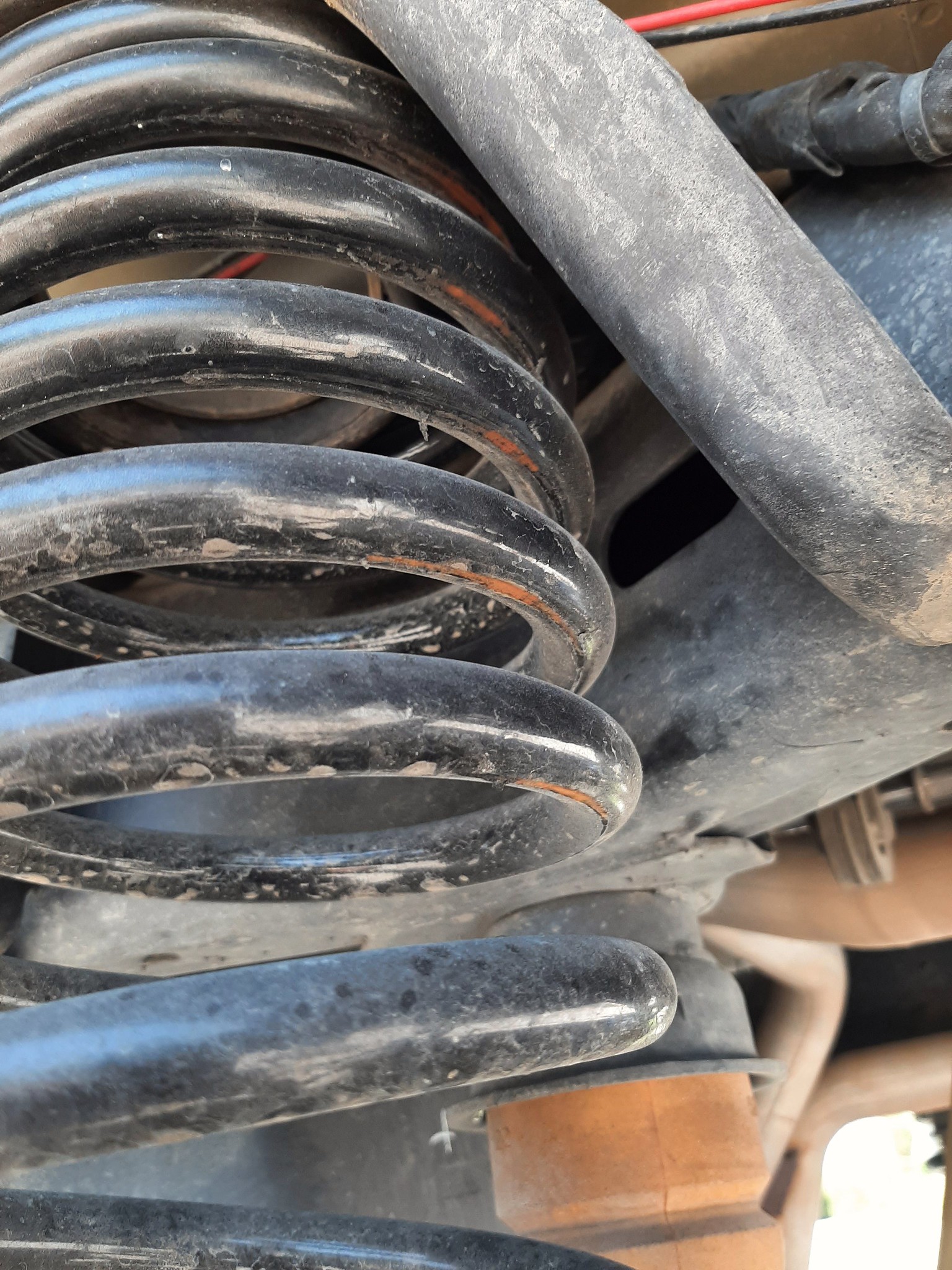

Clayton fitting the upper perch
2020-05-01_08-41-05 by
RAM RSM, on Flickr

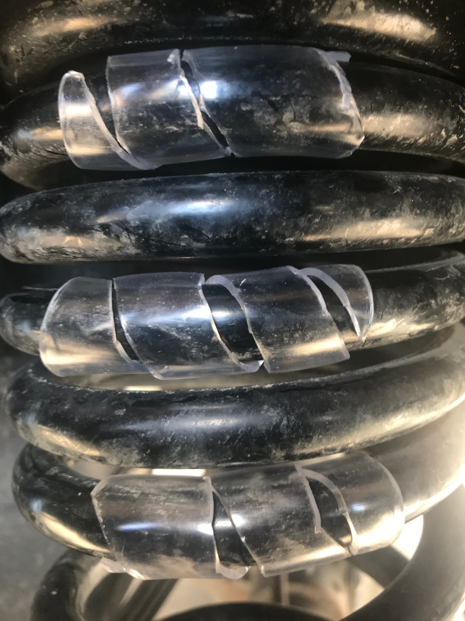

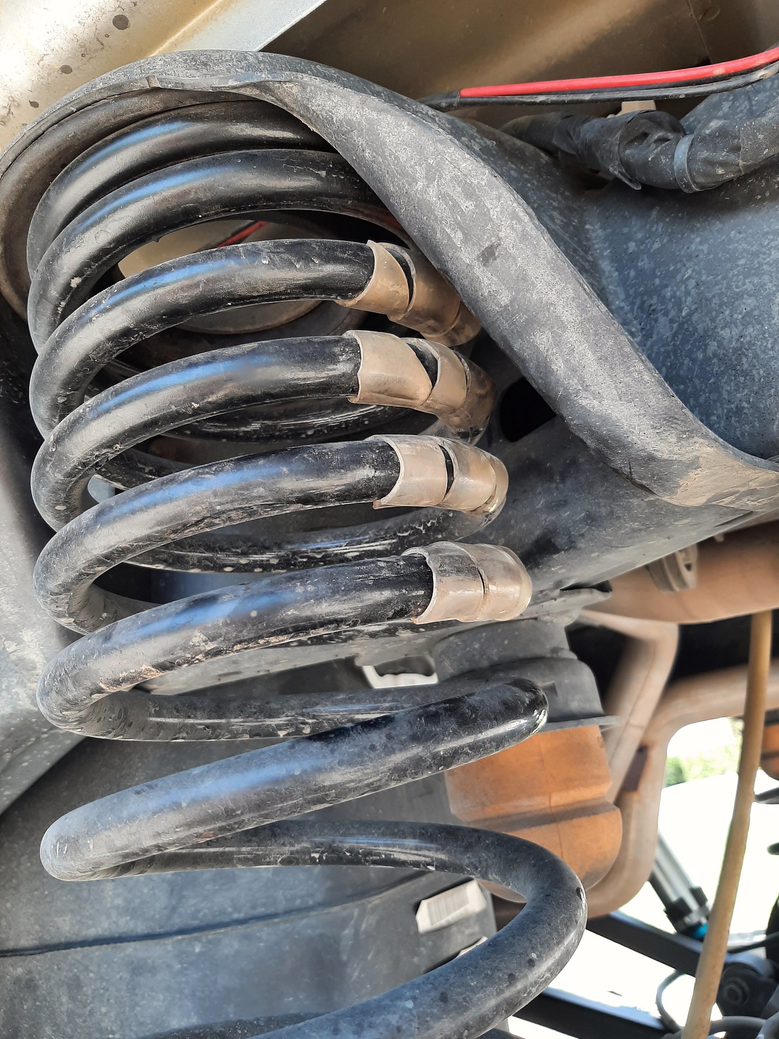

The 1st rate is literally death coils, because of that you may experience some noise when the coils contact each other. I've been running them for a while and the noise didn't bother me much but you can see where it touches.
2020-09-05_05-44-40 by
RAM RSM, on Flickr

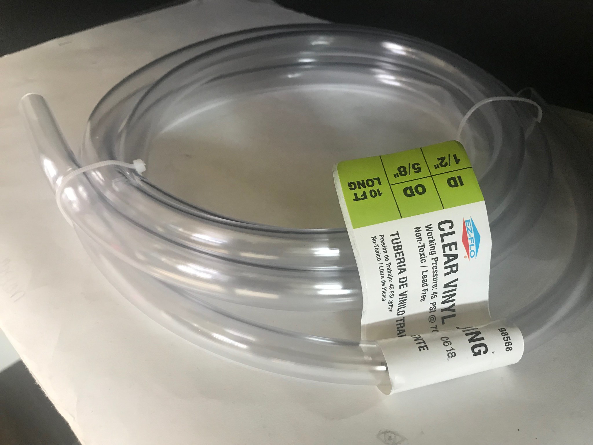

I decided to address the noise this way, you can use anything you want, black hose, aftermarket coil bound isolators etc etc, anything you can put in there will work just fine,
2020-09-05_05-44-48 by
RAM RSM, on Flickr
