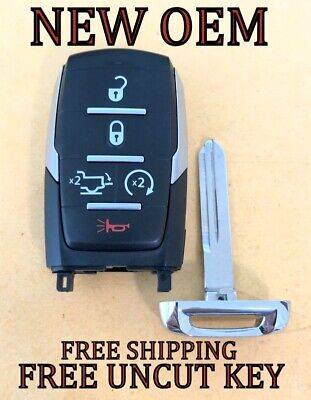

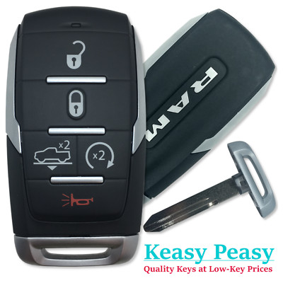

I just bought remote on eBay has to be new or refurbished and called a locksmith to program the fob and tailgate release worked on my 2021 ram 1500 big horn just be careful as I bought first fob and it was for a ram 2500 and up which does not have the led on fob. The remote I had to buy is an OHT-4882056 which has the led on top of fob I did not have to go to dealer
Do you have a pic?
That’s the one I bought but man they have gone up in price I bought mine for 99
Found that one cheaper they say oem is better but they do sell knock offs but it’s hit or miss
And it works for your tail gate drop? I’m going to do that now…
Yes as long as it has the damper so tailgate won’t drop my big horn had it so yours should have it
Remember I don’t have the proximity that unlocks doors without having to use remote so if yours has that I’m guessing it’ll work don’t know ask seller before buying remote
I confirmed it does work, I bought this remote and now my tailgate drops with it.IMG_4376.jpg
