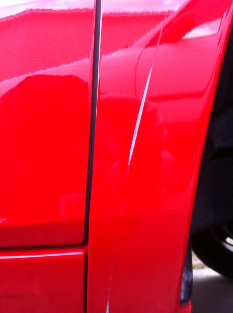

This exactly...... yes, I meant the paint/clearcoat underneath the mud flaps and around the edges. All flaps without PPF on the edges will do this to some extent (it happened on my old truck) ....but the OEM's will wind up being even worse because they extend almost 1.5" onto the fender painted surfaces. Small sand/dirt/salt particles will eventually get between the plastic piece that fits over the paint and act like sandpaper between the two. Again, it may not be a big deal to you if you don't care and it's hidden (but I've also noticed it on the immediate outside edges of flap/paint - the flaps are still going to flex & move slightly due to road wind shear/force in motion).....the other major issue with the OEMs are that they are debris collectors in the pockets which cakes up (even if you drill a drain hole) over time and leaves small rocks, dirt, salt, etc. in said pockets. There was another thread here somewhere about mud flap/paint issues...I'll see if I can find it.
EDIT: I know I saw something about the Mopar OEM flap damage somewhere...either here or another site but for the time being....here is link to a site discussing the problem w/photos with another make:

This exactly......sorry for the late response but , yes, I meant the paint/clearcoat underneath the mud flaps and around the edges. All flaps without PPF on the edges will do this to some extent (it happened on my old truck) ....but the OEM's will wind up being even worse because they extend almost 1.5" onto the fender painted surfaces. Small sand/dirt/salt particles will eventually get between the plastic piece that fits over the paint and act like sandpaper between the two. Again, it may not be a big deal to you if you don't care and it's hidden (but I've also noticed it on the immediate outside edges of flap/paint - the flaps are still going to flex & move slightly due to road wind shear/force in motion).....the other major issue with the OEMs are that they are debris collectors in the pockets which cakes up (even if you drill a drain hole) over time and leaves small rocks, dirt, salt, etc. in said pockets. There was another thread here somewhere about mud flap/paint issues...I'll see if I can find it.
The newer (mine purchased last September) do have drain holes in the bottom. They do collect debris and have to be washed out, though. I am careful to wash them out each time I wash the truck.
