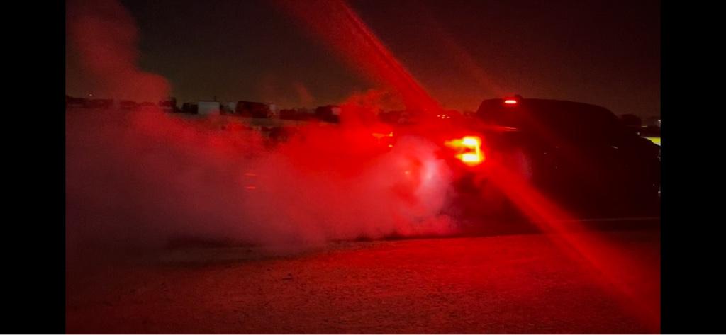

Hi guys, recently got myself a 2021 RAM 1500 limited and wanted to put the factory tires to rest and what better way to do that if not by doing burnouts! So I did some research online and these are the methods I tried:
Method 1: 2wd, rear axle lock, traction off. Step on the gas and as she begins to move, stomp on the brakes (tried feathering the brake pedal as well). As soon as I press the brake pedal, almost immediately power cuts off to the engine and the driver cluster screen shows "Performance may be limited. Press one pedal at a time" message. No burnout!
Method 2: Pull F26 fuse from engine bay fuse box. 2wd, rear axle lock. Try to do a burnout and the exact same thing happens again and I get the same message.
Anyone know what I could be doing wrong? Is there a way around this?
Any help is appreciated. Thanks!
Note: I'm in the Middle East and the truck is middle east spec as well.

Start with the brakes applied. Then hit the gas pedal and slightly let up on the brakes until the tires start to spin. Obviously, axle lock and traction control off. I've never had an issue with doing burnouts that way. I do have a TazerDT now and the line lock feature makes it far easier
Happy to report this worked! Brakes before gas was the way to do it.
Now that I think of it, have only done burnouts in a manual before which is what threw me off.
Thanks for the tip!
