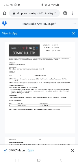

The brake moan is a well documented issue and is covered in TSB 05-002-19 (dated April 25, 2019). The TSB states "If the customer describes the symptom/condition listed above, perform the Repair Procedure." This means the dealer DOES NOT have to replicate. Take a copy of the TSB to the dealer and tell them to fix it.

Here's a link to the TSB section of the forums; you'll see under "brakes" the first entry there is the latest fix which I believe is to add an bracket primarily. Clink the link and you can print the PDF and take it to the dealer.

We've upload the .PDF of the TSB, and like everyone above said, make the dealership (especially if it is a certified CDJR dealership) replace the pads.

With my truck having a August 2019 build date you'd think when I asked if there were any TSB's and me bringing it in specifically for a rear brake moan, they would have caught this! #LetDownByRamServiceOnceAgain.
RevRonnie
Feb 18, 2019
11
2
Sorry. Tapatalk wouldn't let me upload full resolution.
