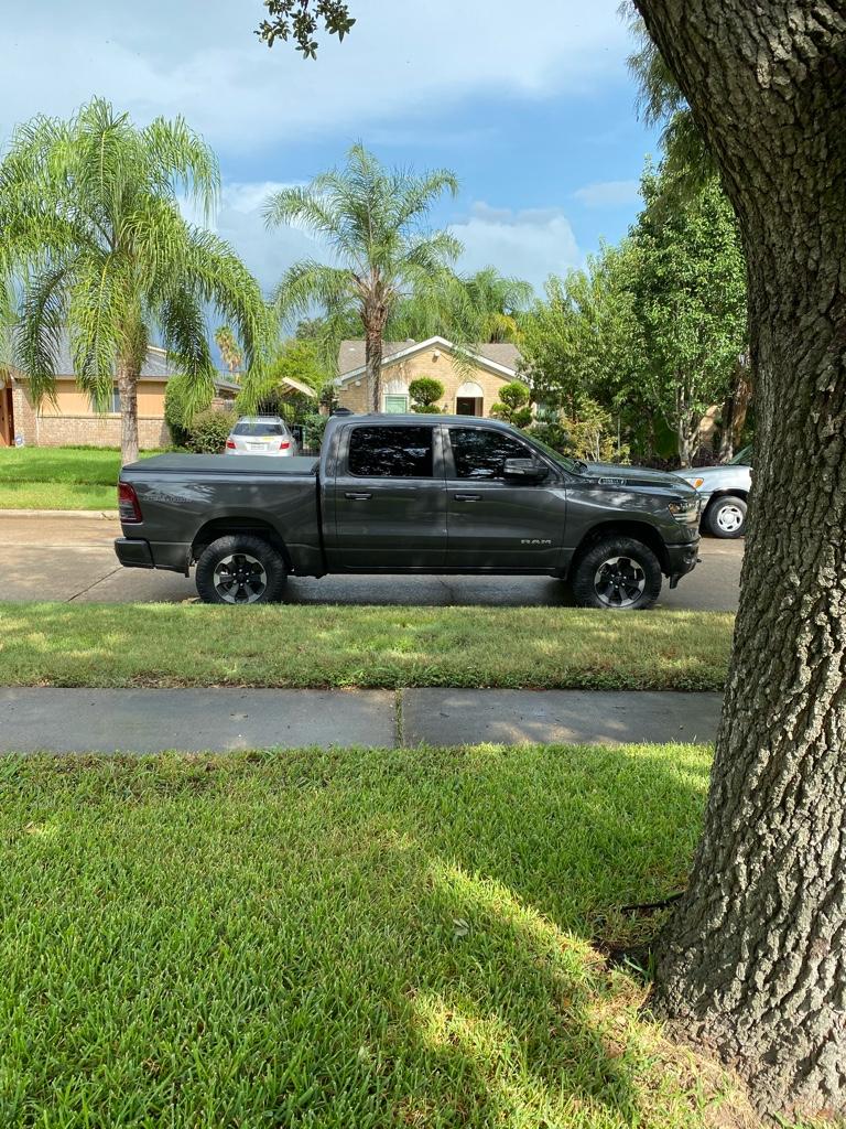

Do you have pictures of the shock installed? Something isn't right. I believe setting 5 should still leave you with a small amount of rake.

from my understanding, setting 5 on normal springs would leave rake, but with ORP it is super close. It may be thatthe truck is completely level, but the lines (and high clearance bumper) make it look nose high.
So I ended up doing the bilsteins at notch 5, this is how mine sits.
Before and after. 2020 ram V6 stock 275/65/18
Front
Bilstein front setting 5
Add OPR springs
Mopar lift UCA
Rear
Bilstein shock
Motofab 2in spacer
Ready lift bump stop extender
Front 39 3/4
Rear 40 3/420201014_173340.jpg20201014_173318.jpg

If I could do it over, I would have gone with level 4 on my ORP instead of level 5. Level 5 has left me looking almost nose high (even after 9,000 miles and settling). I think level 4 would have fallen perfectly at about where I would want to be.
I realize this is an old post/thread. The Zone Off-road UCAs add an extra 1/2" of lift above what the Bilstiens give you. This is why your truck sits level and almost seems nose high. I added a 1" lift puck in the rear to compensate. This was easier than pulling the Bilstiens to lower them a notch, and just gave a better stance.

I found this by installing them on my truck. And doing before and after measurements
