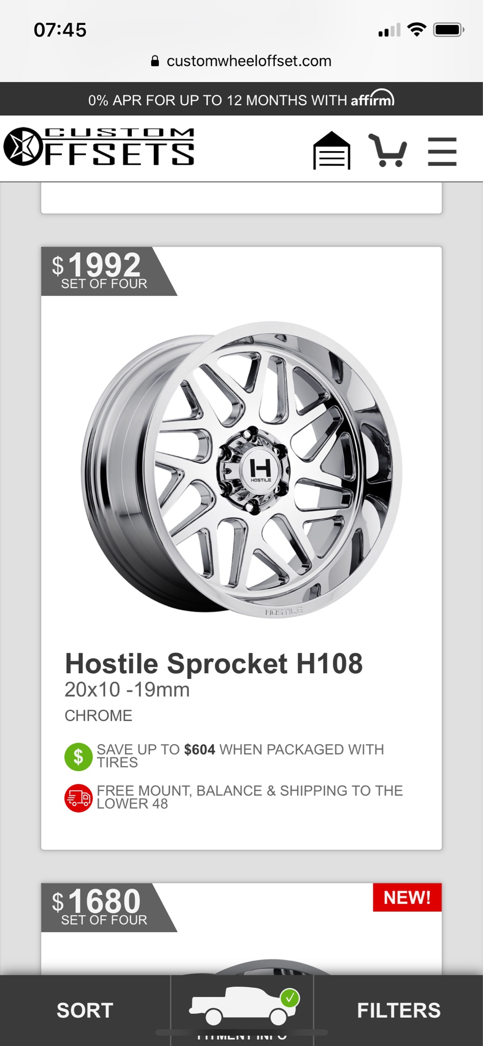

Custom offsets sent me the following
275/60/20 on a 20x10 -18 or -19 would fit on stock suspension no air ride.

Hostile has a decent set in 20x10 -19 that I have been told will fit nicely.
