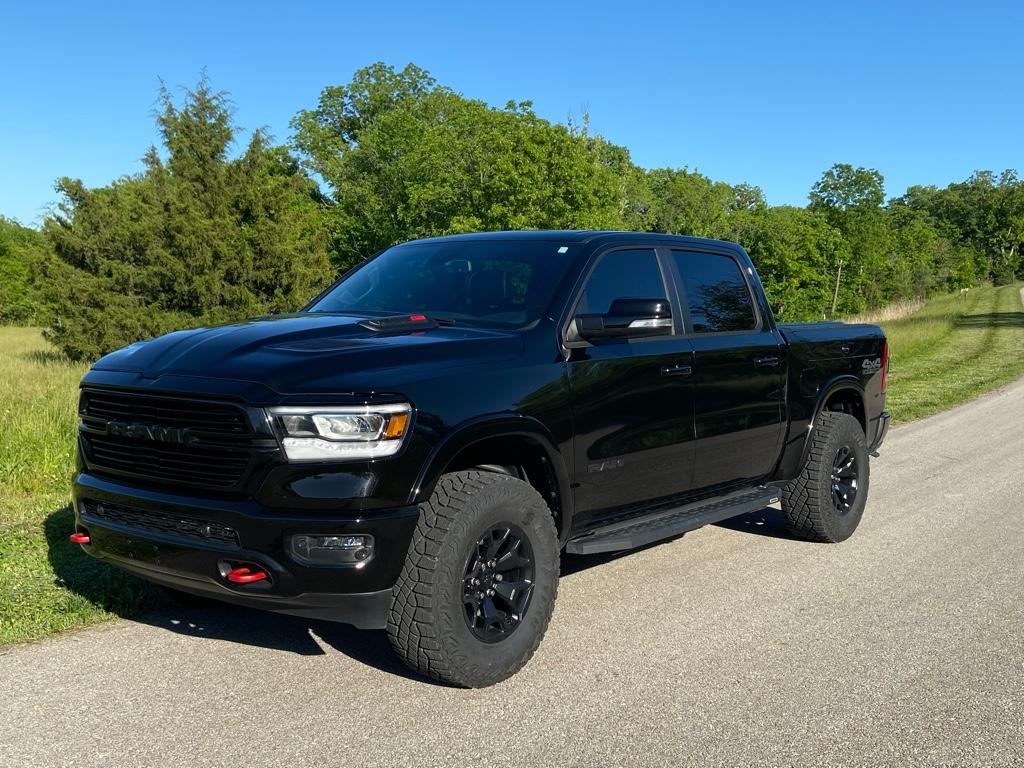

Probably, if not just a bit higher. My truck is an ORP, which I believe is 1” over normal Ram height all around. I also put a level kit on the front, so I’m sure I’m roughly 3” higher than a stock Ram without ORP.
I see a lot of guys running 34 and 35 inch tires, curious what you are doing for a spare and what will fit under there?
I just changed my tires and wheels. Added 17” AEV wheels and 315/70R17 BFG A/T KO2 tires. The wheel size is 34.4” x 12.4” wide. Fits under just fine with a small amount of push from underneath fully inflated. I did not add any lift and I have no rub during turning. Not sure I would have wanted to go larger because I needed it to fit underneath. I believe one could get a 35” underneath by airing down the spare but could rub Ft tires unless having a lift.

Airing down your spare tire defeats the purpose of having a spare tire

Well, I suppose for some folks. For me, I air my tires down and up when traveling and exploring places, getting in the sand, mud, rocks, snow, etc, so I have a on board compressor wired in to get ’em back up to needed pavement PSI. Would not be a problem.
