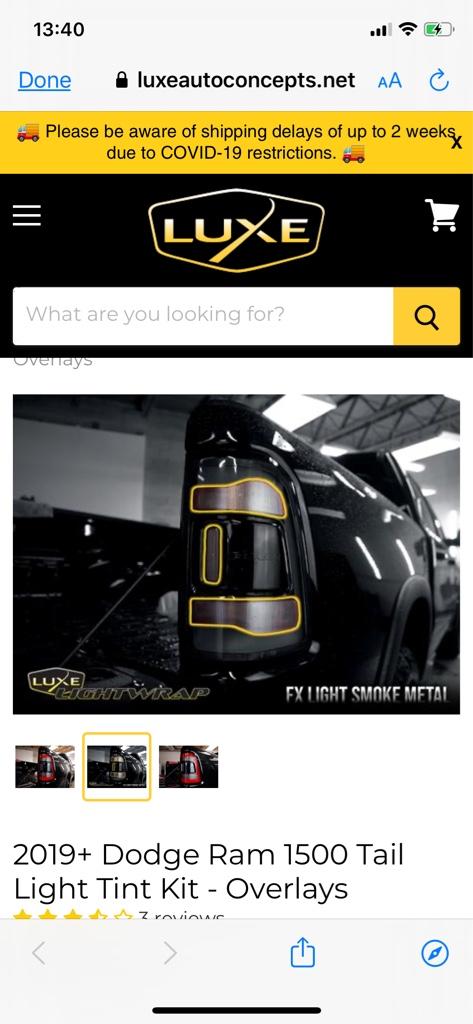

Can you please take a photo up close of the sensor area and the area immediately around it and the backup light? I put on lumin X tint but it left the center in covered and it’s driving me nuts. I don’t want to risk screwing it up by painting and am hoping what you used solves my problem. Thx

After looking, does the kit only come with the highlighted pieces in this photo? If that’s the case then it doesn’t solve my issue. I was hoping their covers including the sensor housing
You are correct. It is only the highlighted pieces that the tint covers. You must have the blacked out tail light or paint them for the full effect.
