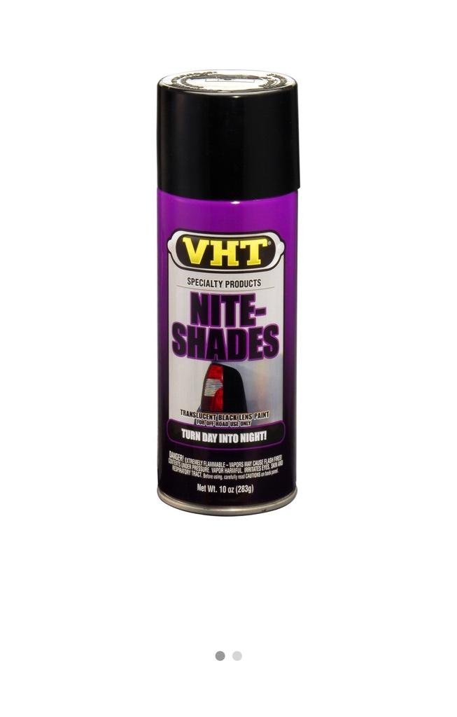

I want center of my tail lights to be black like the picture below. What should I do? (My tail lights "Do Not" have Blind Spot/ Cross Path Detection)
Sand paper, Nite Shade, clear coat, mild rubbing compound.

Did you remove tail lights before applying or did you mask off truck and apply with Tail lights in place?
LaxDfns15
Sep 30, 2019
1,510
1,238
Memphis, TN
You're going to have to mask around the light anyway, might as well leave it on the truck. Just put a layer of newspaper around the last layer of tape.
