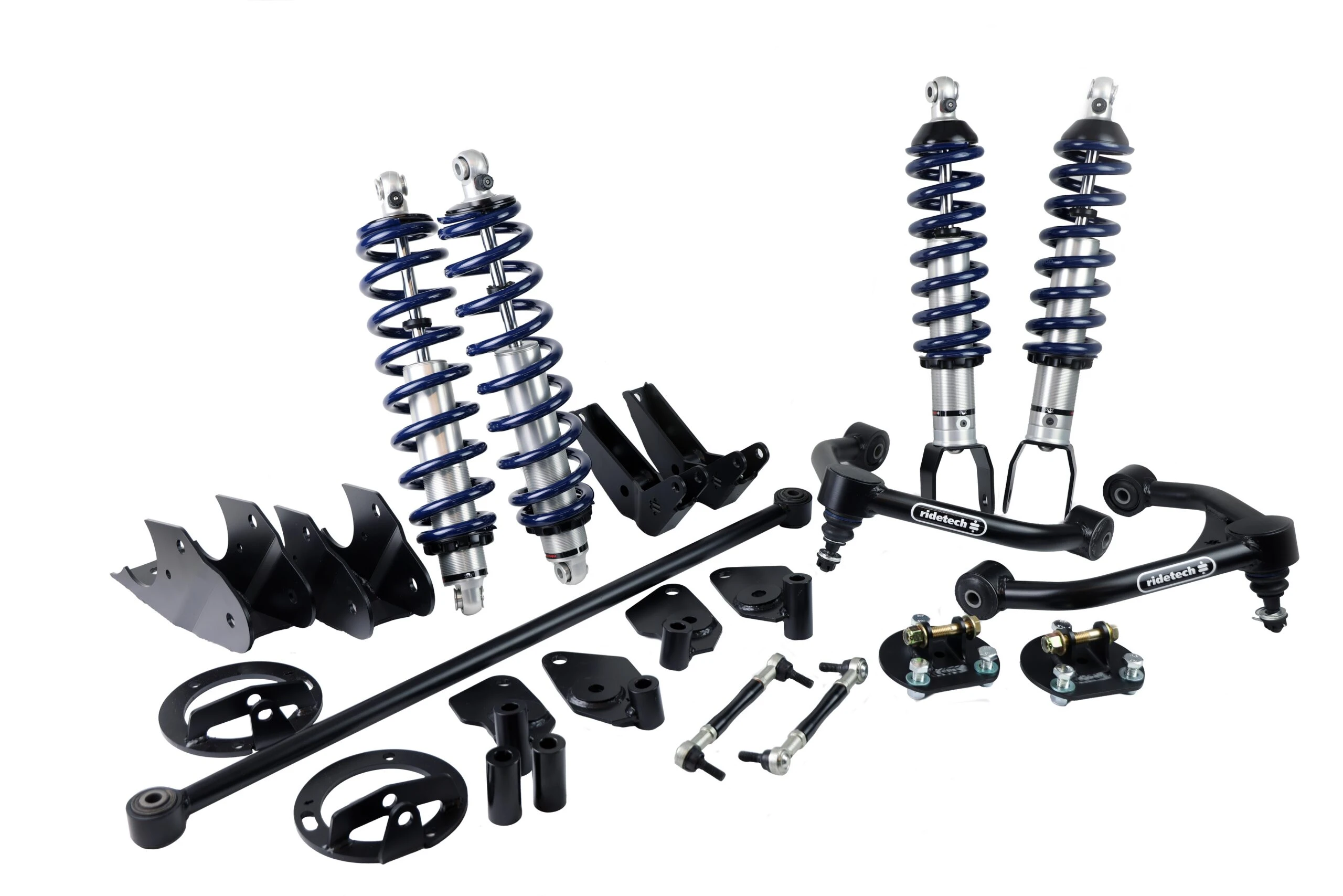

Stock height struts should work fine if you use the Belltech spindles. As far as any updates to the spindles, I have not seen any post here regarding that. Which TG bags do you plan on using? You might look into Ridetech. Their kits are adjustable so you can adjust ride height and rebound, allowing you to “tune” the ride to your liking. You can get the full kit or just the front coilovers and control arms and do whatever you want in the rear.
