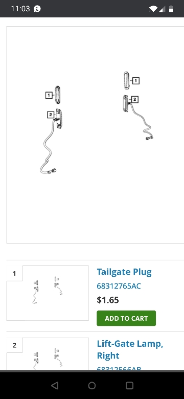

So my truck for some reason or another does not have covers where the factory bed lights are suppose to be installed. I am guessing they were removed when the bed got rhino lined and never replaced. whatever...I am trying to find a part number or a set of these? Cant seem to find the part number on any diagram. any help?

Pretty sure it is 68312765AC
