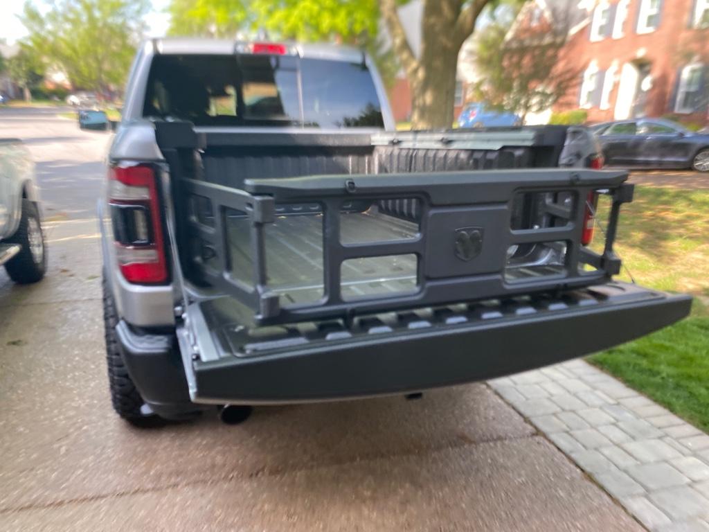

I think this one’s kinda neat.

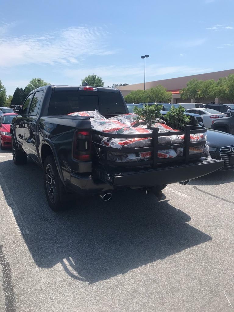

I use and like this, but it is different from what others have shown: https://www.amazon.com/gp/product/B00008BKX5/ref=ppx_yo_dt_b_asin_title_o02_s01?ie=UTF8&psc=1
Up to 10 feet long I just put in the bed with the tailgate down, put a ratchet strap around the load to hold everything together and then use another strap or two to pull the load firmly into the bed so it doesn't slide out. It has worked great on 2x4s and drywall. 12 foot or longer I will use the illustrated device to support the load. I have used it a few times for light stuff, molding, in the vertical mode that was as much as 17 feet long. I that case you need a bar on the cab too. Worked great. Kind of needs a bungie or two to keep it from rattling though.
