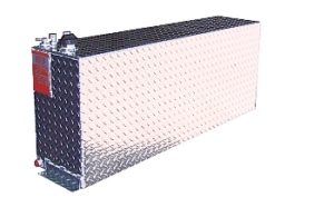

kittyjo
Nov 9, 2018
473
142
Here’s what I’m thinking… low profile and can close the top no problem
Richard320
Aug 3, 2019
2,091
2,223
If you connect that permanently somehow to the gas tank, you may mess up the EVAP monitor and set a bunch of codes and check engine lights. Diesels do not have an EVAP system, so none of that matters. Also if it vents into the tank, it may overload the charcoal canister and ruin it. Trapped under a tonneau, any fumes venting may gather which would be really dangerous. You'd want to set up a bilge blower like a power boat has.

RDS makes a load of awesome tanks, this one sits about 1/2 inch under the bed sides with the pump’s nozzle holder removed. Though this tank won’t work because you need the longer bed but they do make a similar one that could fit.
If you’re going to go against DOT guidelines at least make sure the tank is approved to store gasoline, and put a valve on the fuel line going into the tank and vent the transfer tank out of the bed. Letting fuel transfer while the truck is running Will set off a bunch of error codes as stated above.
You’re also probably going to need some anti static fuel line to safely transfer the gasoline, unless you don’t mind your truck potentially becoming a ball of fire🤣
Have you done much research into what size tank you want?

I made a tank from the Bottom 8" of my toolbox for my '08 RAM Bighorn. There are DOT regs, EPA regs,
and the trucks computer to deal with.
DOT needs OEM or better Parts. I used SS braided line with Aircraft fittings.
EPA needs you to pull from the top of the tank, you can't use a drain system.
It has to be a sealed system for the computer. So along with the Transfer Line, you
need a vent line between tanks. I ran both lines to the filler neck with the vent a little higher.
As long as the Fuel gauge goes up and down there won't be a code thrown for a Sender unit
or gauge malfunction. I can transfer mine on the fly while driving.
I am currently adding a AUX tank to my 2021 Ecodiesel of 72 gallons. with the stock tanks 33 gallons,
and getting the claimed 29 MPG that gives me a range of around 3000 miles.

I look foward to seeing your complete setup, is the tank going to be custom?
Malodave
Oct 4, 2020
1,113
605
Rindge NH
Yes. it will be 20"H x 60"W x 14"D. The Filler neck will be accessed thru the Windoors of my Bed Cap.
I just need to tap a few holes for the transfer lines. Then get it to my welder.
