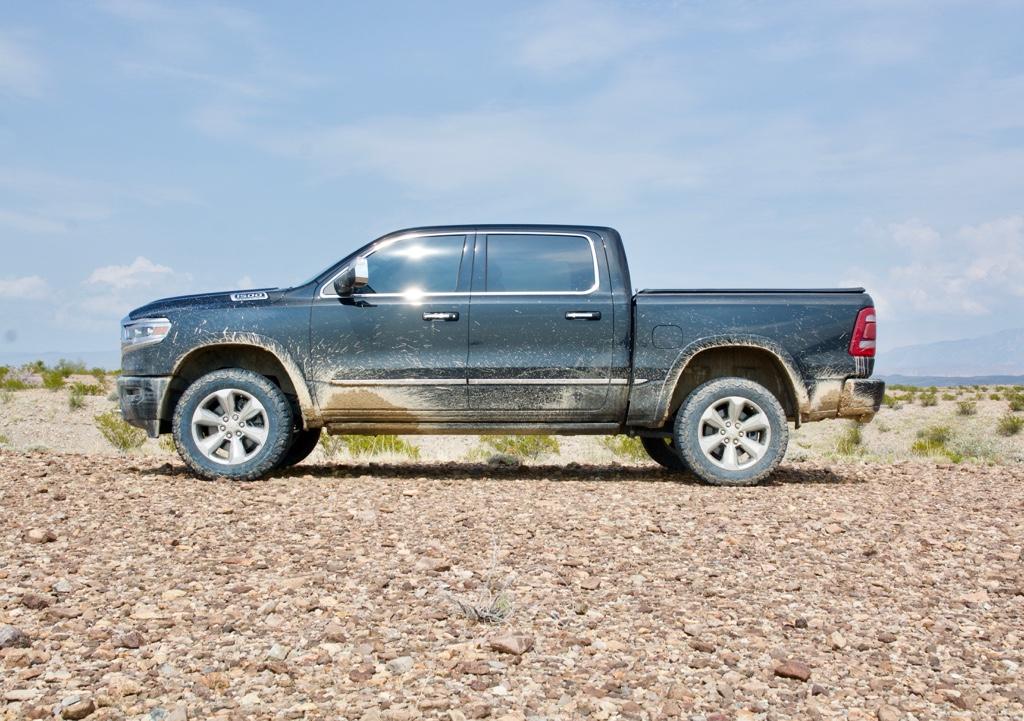

Not what the OP is asking, but for the sake of others who will look through this thread in the future, I’ll post pictures of my Limited, non ORG, with the stock 20s. I’ve got 305/55/20 K02s on it and it rubs at full lock in Aero at parking lot speeds, otherwise I have never had it rub in Aero at speed.
Entry and Exit has about 60% of the turning radius before it rubs.
Should be pointed out - the rubbing is very minimal. More scrubbing than it is a full blown rub in Aero. Entry Exit at full lock is definitely rubbing bad.
Aero could be fixed by removing the small plastic pieces at the front and rear of the fender liners. I will eventually get around to it, but i have yet to rub while driving in Aero at speed on the highway.

Seems like any tire wider than about 11.5" starts to rub. Those tires you have are listed at 12.4" if people are interested.
