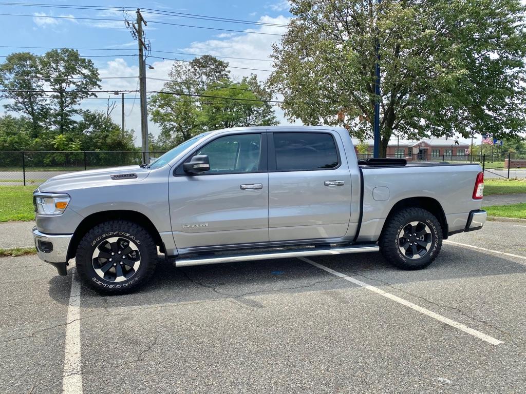

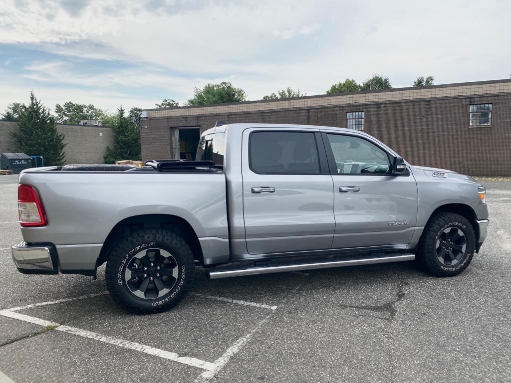

Took the plunge as well. The Duratracs are definitely louder but very noticeably firmer in the turns, truck feels glued to the ground. More than happy with them.
MetalDog are you riding on air? I have a Rebel with no air and wanted to go LT295/70 but didn’t know if it would work I don’t want to mess with the suspension.
Yes, im on air,
