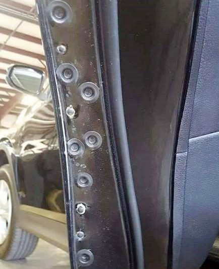

So, the journey started today.
First up, a referral. The lady was super nice, said $175 and a few hours would have it damn near perfect. However she had to drill a hole in the door jam. She did say they could do conventional, but it would be filler + paint that I probably wouldn't' like.
I called another referral who is out of town, he said he could likely do it based on pix and would only offer drilling if I was looking to save money.
A quick search tells me that I may be able to avoid drilling. I found this local article, and contacted the testing facility to see if I could get a referral.
It is no doubt an art, and finding the right guy or gal is key.
Fingers crossed.

I had a small ding fixed in my passenger front door with PDR at a local shop. They used a glue puller device to pull it out, then tapped it down to level it. No drilling required. It cost around $100 and they got it perfect. My truck is black so anything less than perfect would show. I had them pull some of the infamous" roof dents' on my Dodge Challenger the same way. Ask these shops if they can use this method to avoid drilling.
SD Rebel
Jun 29, 2019
4,149
3,576
San Diego, CA
Yup, of the top rated PDR shops in my area don't drill, they use a glue puller device for dings they can't access from the back-end.

Drilling to PDR a dent... Nope nope. Keep shopping around.
