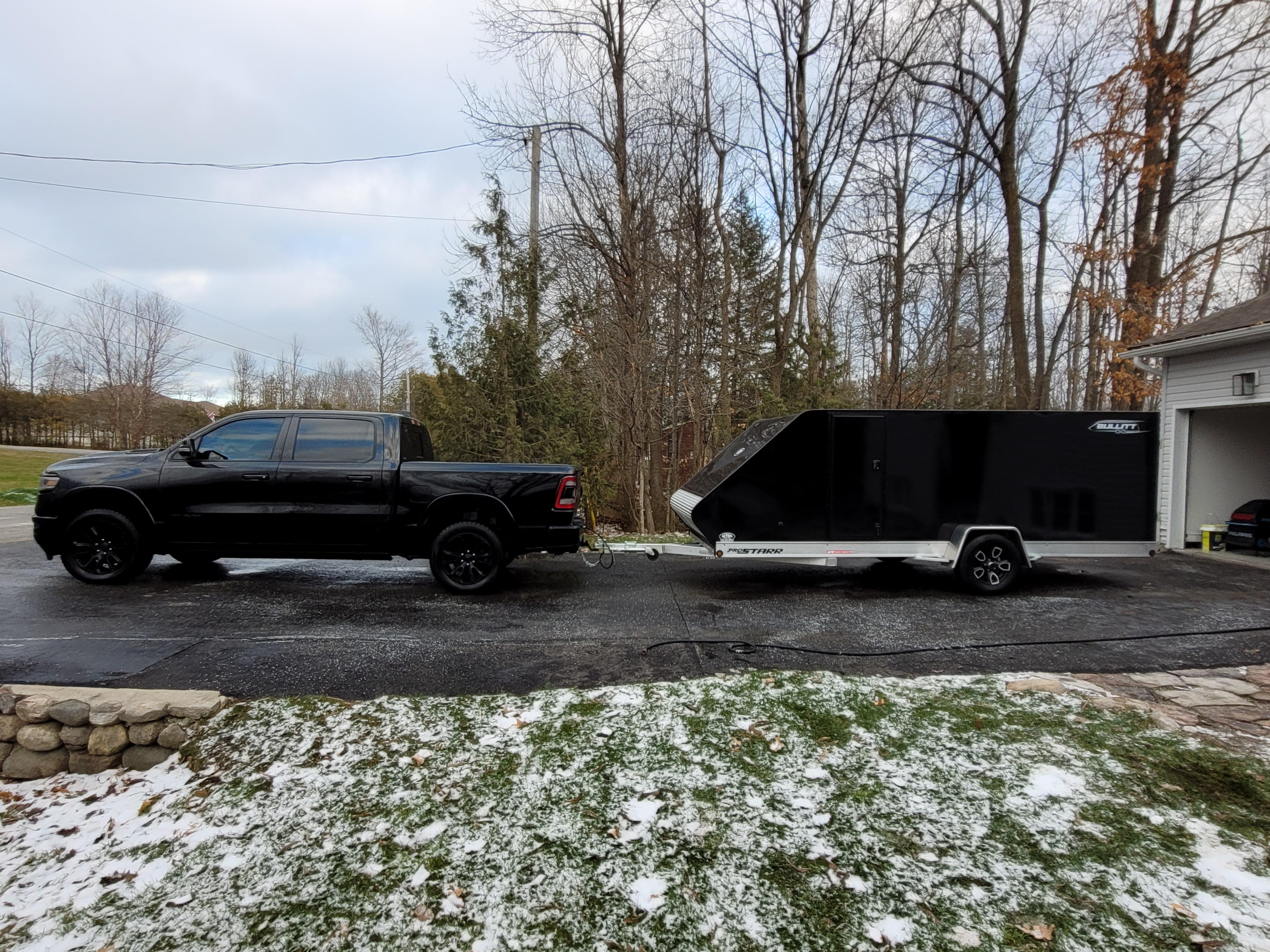

My ED towing my 7x16 enclosed snowmobile trailer gets better mileage than my Hemi did empty.
