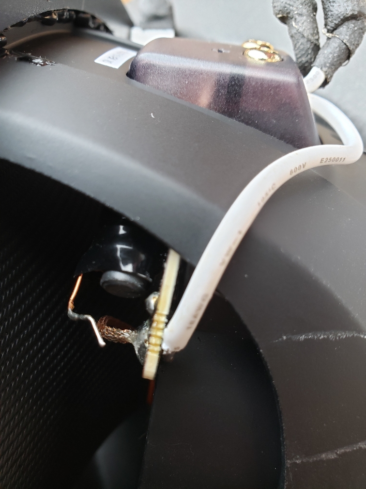

Where the Kappa 93’s in the doors 2 ohm ? And ya know the front doors are low only ?
93ix are 2.5 ohm. And yes I know about the low pass only. So I modified the built-in cross over to bypass the inductor and let the tweeters get what they could with the capacitor (nothing really) but bass response is better than stock. Probably could have skipped fronts tho. Overall big improvement w/o getting into wiring amps etc.
