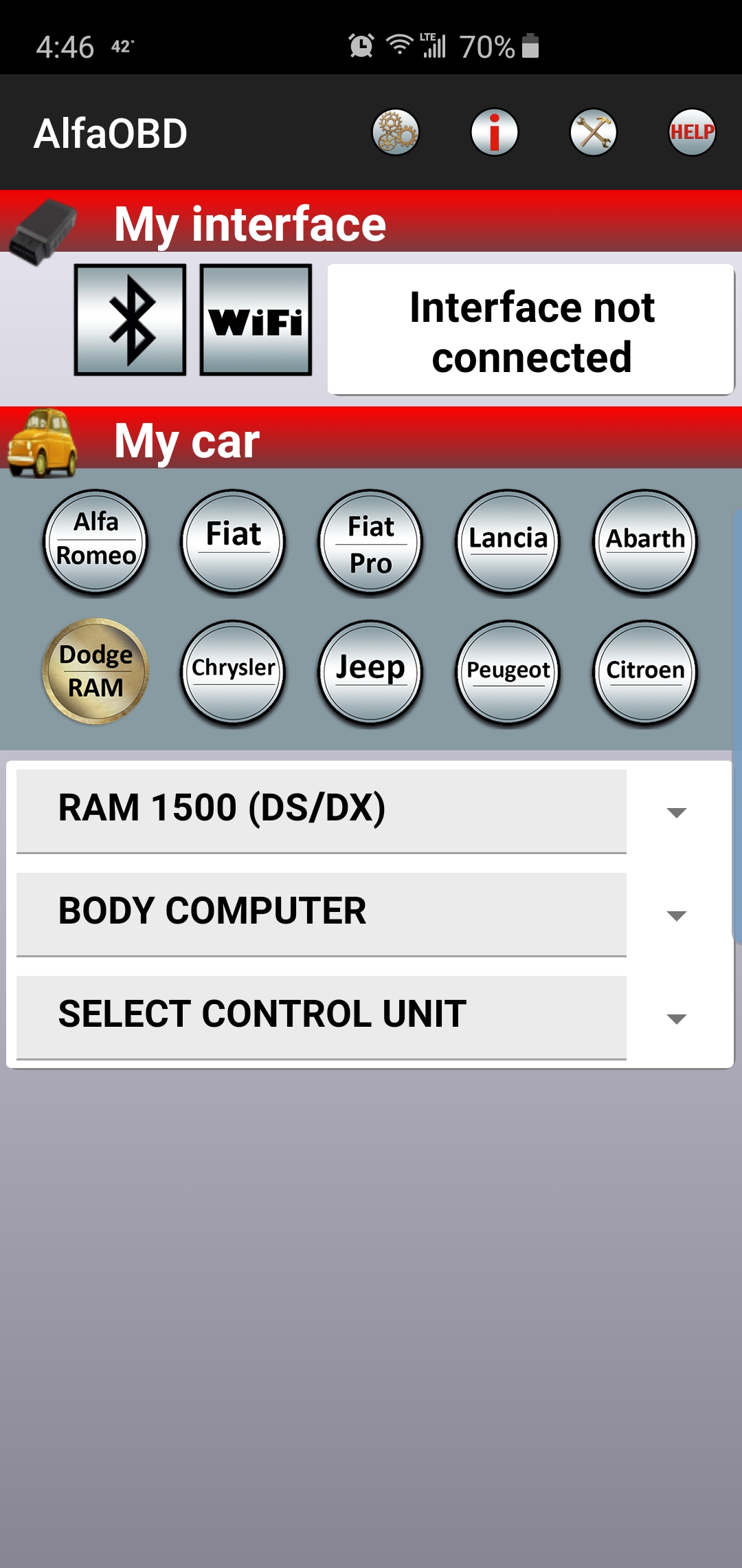

Yes the Alphaodb will work with a 2019 Ram DT. In Alphaodb you have to choose DS. But most functions still work. You must have Bypass cable of some sort. I have changed fog light drop out and DRL source to Amber lights vs LED.
datammwv13, Do you mind sharing the details and steps... on how to keep fogs on with bright lights.
Next time I connect I will take some screen shots and do a write up. Cannot do without connecting to see screens in AlphaODB. But fairly simple to notice.
DRL Dropout Enabled
Select “yes”
