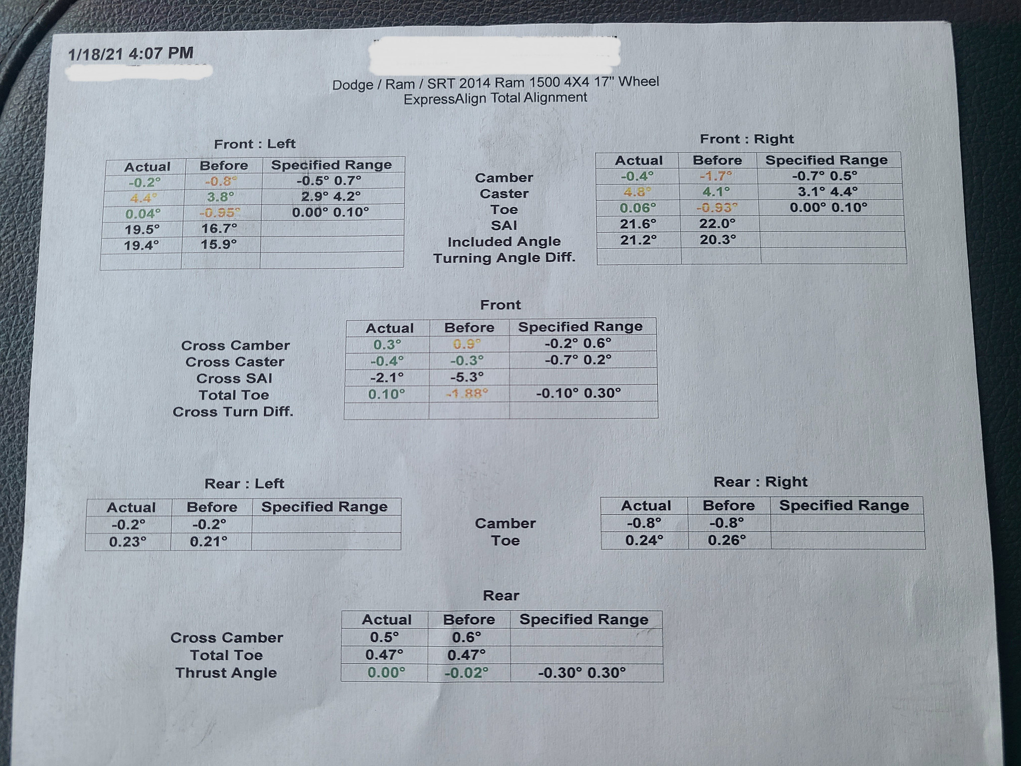

Ram1500rsm
Aug 22, 2020
191
121
This was my print out couple of months ago after adding bumper and winch and adding around 4-5 turns in my coilovers to add more preload to counteract the effects of new weight. Notice how everything moved, and this wasn't 2" more. it was prob 3/4 on both sides. I like a slightly neg camber cause i tend to be a little more aggresive with my rig in dirt roads. and i like my caster close to 5* as i like my tires a little away from the inner fender seams. That's how i was able to run 37's before :)
