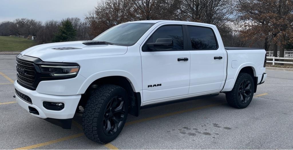

Yes the links are creating the problem of OR2 not available. The photo you posted of the front end looks like the suspension is already extended, hoping this isn’t what “normal ride height” looks like. If so, you are not experiencing the true ride quality of the air suspension.
Post an overall photo of the truck and the tire size, we can help ID the other possible issues and which ones are critical.
For reference, here is my 22 with leveling links. Like another mentioned, OR2 is not available as my truck has the off road group from the factory. Running 285/55r22 tires (34.5”). Ride is still like factory and I use aero mode with no rubbing.
Is your speedo correct? Depending on the tire size saved in your ECM.
Looks good.
