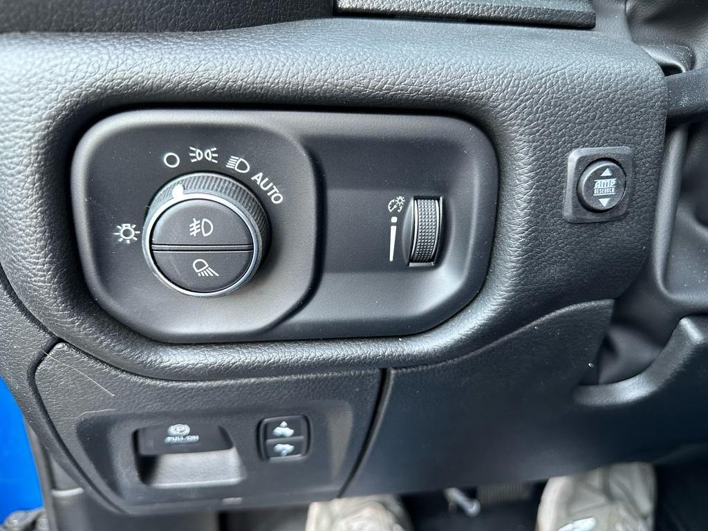

That switch is small enough and blends in well enough that it really wouldn't bother me. Not having to click through the touchscreen would be convenient.I have AMP Research PowerSteps on my 2022 Lone Star and they integrate really well. They deploy when I open the door and retract a few seconds after closing the door. They do require a separate switch for manual override, which I installed next to my light switch.![]()
Which option did you go with on the switch? I was lookin at these yesterday and was going to pull the trigger but there were controller options I didnt follow for the switch.I have AMP Research PowerSteps on my 2022 Lone Star and they integrate really well. They deploy when I open the door and retract a few seconds after closing the door. They do require a separate switch for manual override, which I installed next to my light switch.![]()

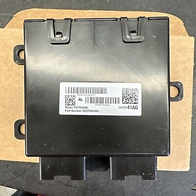

Im turning in my 21 for a new 24. They are letting me pull the power steps off my 21. The factory pigtail looks like its built into the oem harness so I couldn't do much about that. Does anyone know if the pssm will work from my 2021 to the 2024? Also is location still underneath steering column?
I appreciate the quick response. The dealer said I can take the PSSM with me; I have no idea if it will work on the 2024 though. When I go to oem parts it shows the PSSM blacked out under exterior/running board and side steps. Lots of the "kits" showing 19-24 but I dont know how well the PSSM plays for all years. Surely I would like to think that the last year run they wouldnt take the time to change something like that but I grabbed the PSSM off of it just in case. Hopefully that way I only need to grab a harness. I am not worried about controlling it through the screen as I never did the previously on the 21; just open/close of doors.See if this helps![]()

Does anyone still know if guy on the forum is still making the harnesses up for the power boards? I cant seem to find the thread anymore that has all the part numbers and terminals to build your own or part numbers to order them from the mopar kits.See if this helps![]()
2019 - 2024 RAM 1500 OEM RUNNING BOARD CONTROL MODULE & Wiring Kit 68275941AG | eBay
Find many great new & used options and get the best deals for 2019 - 2024 RAM 1500 OEM RUNNING BOARD CONTROL MODULE & Wiring Kit 68275941AG at the best online prices at eBay! Free shipping for many products!www.ebay.com
