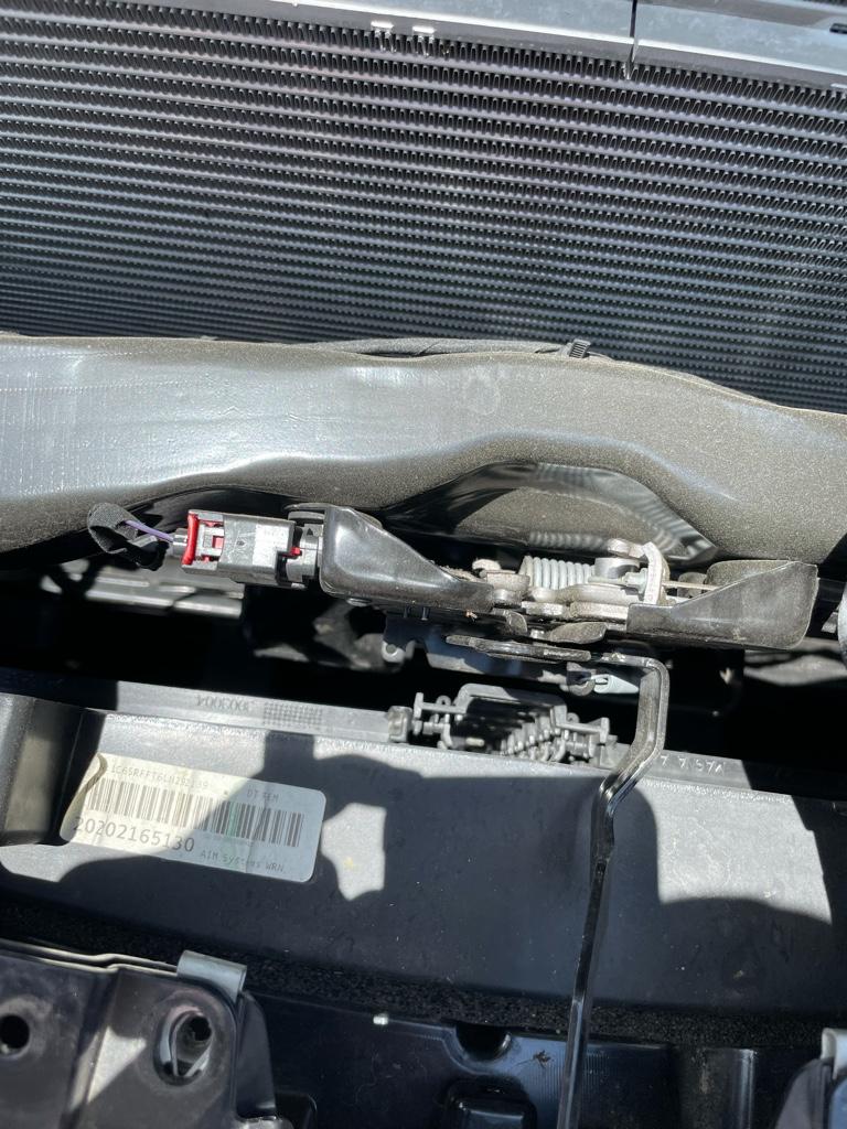

I also attached a pic of the hood latch switch if anyone was looking to see what it looked like
For anyone wondering. The only code you need is the VCONFIG - 1 remote start option. Started working after around 8 hours or a couple cycles of the engine, not sure what did it.

I have a 2019 Ram 1500 tradesman and did not notice the hood latch switch, Does anyone know how I can add this? part # or any other info on my stripped down tradesman lol
I installed a LOT of these at the dealership ..
you may or may not have the hood switch connector taped off up front. You more than likely may not even have the hood latch with the connector on it .. if you do and the cable is already hooked up - you may already be halfway there. That Purple wire with the stripe needs to go inside to the BCM (under the driver knee area) to pin11 on C1 (I think it is C1 .. it is the multi-pin connector at the top left). As long as it is in Pin 11 and you can confirm (easy for me because I was able to use our diag software to verify if the hood was open/closed), then you just need to have the parts place add the sales code to your VIN. Once it is added, the system updates and adds everything -- you still need to program the FOB though.
