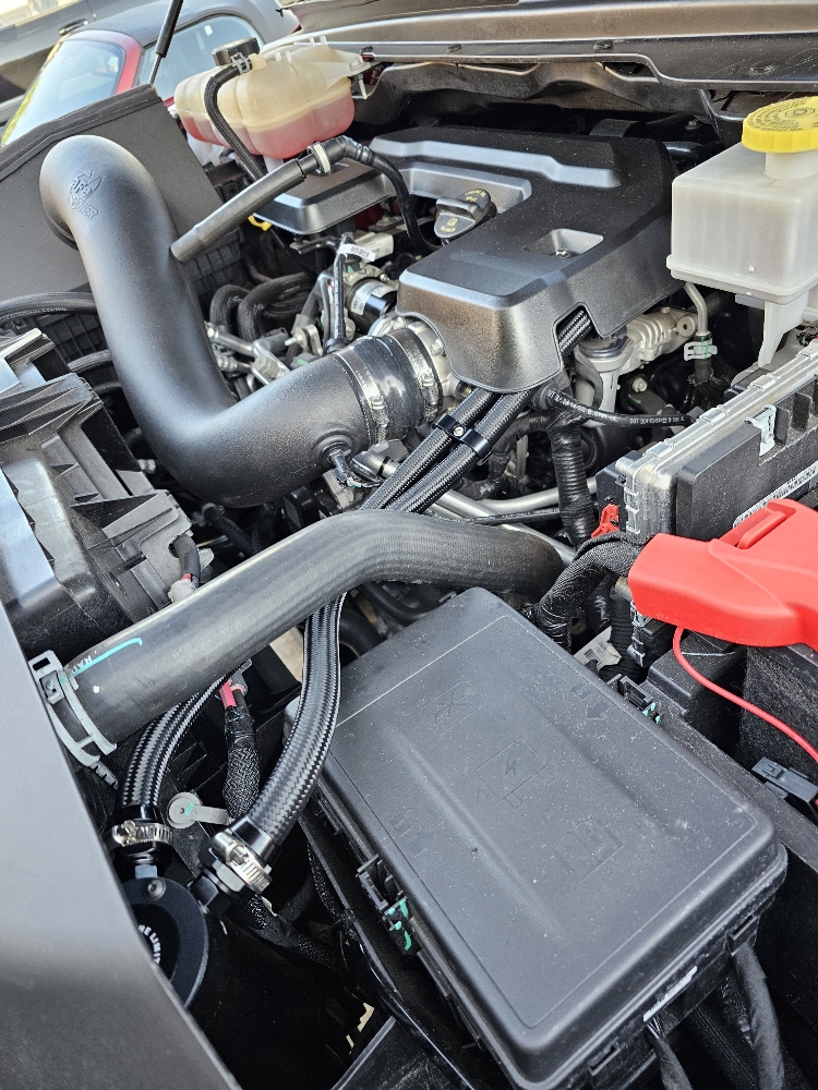

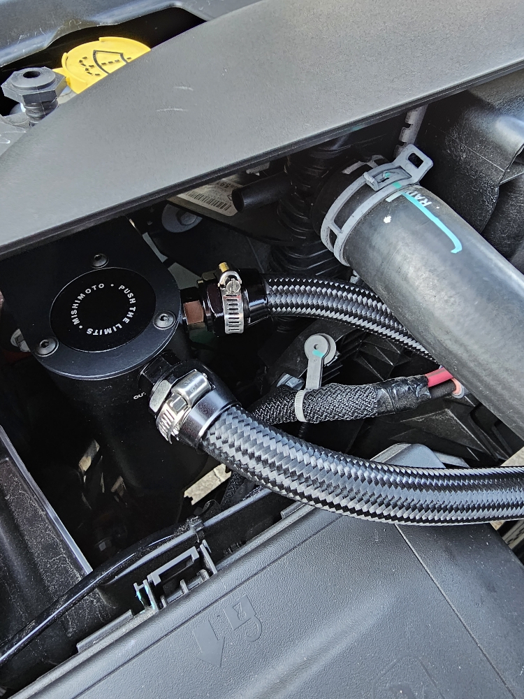

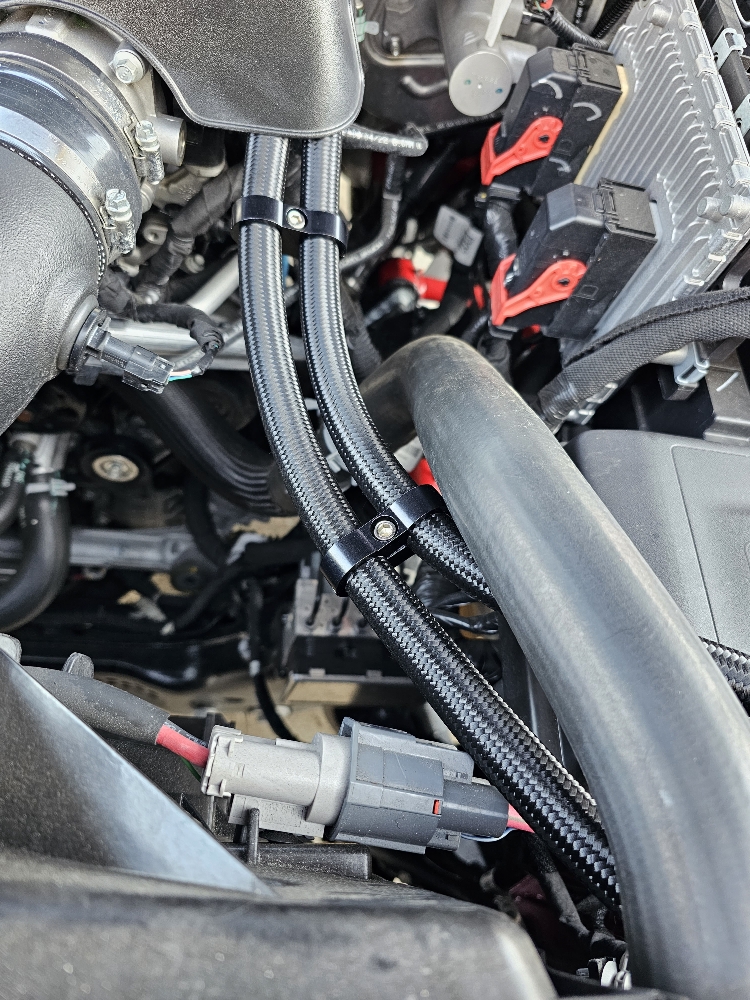

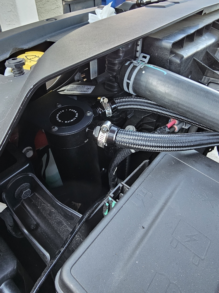

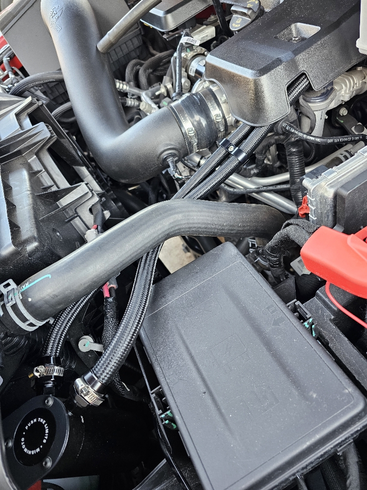

Even when our engines are port injection, the amount of blow by from the crankcase is huge, there's always a big amount of oil being poured back to the intake manifold together with all the recirculation. I had one installed on my 4th gen and did the same in my 5th gen. I'll attach some pictures and of my 5th gen install and willing to guide anyone needing more instruction on how to.

What tubing is that?

I was wondering the same thing. The Mishimoto CC I bought came with rubber tubing.

I used high pressure threaded protect heater and gass lines from Amazon and AN fittings. Wanted to make it look as tidy as possible
