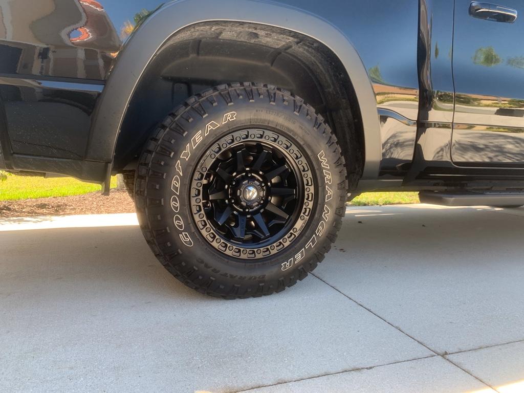

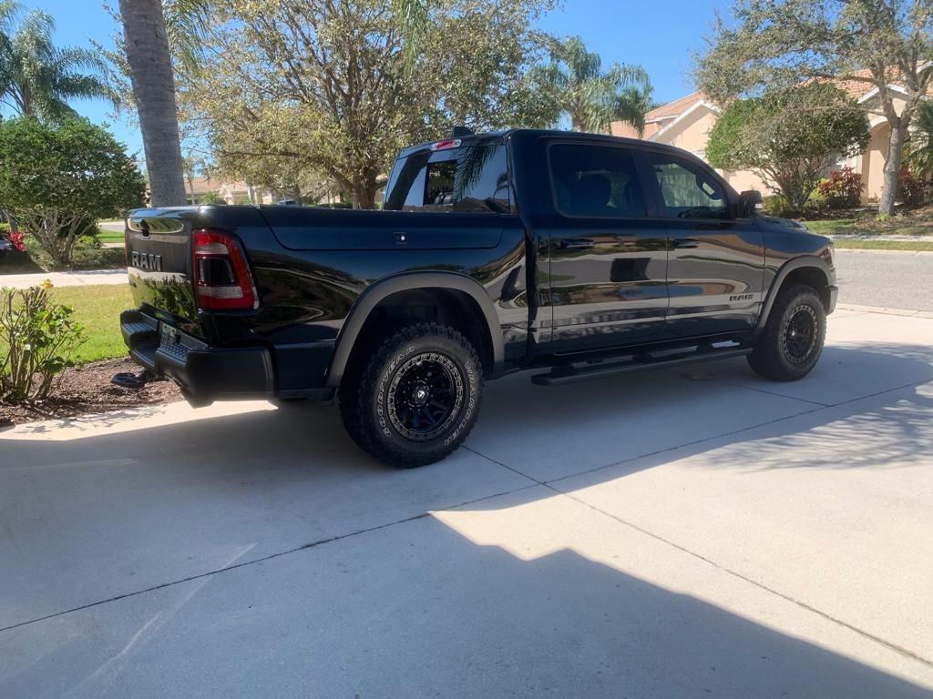

My Fuel covert 18x9 in black with stock tires. The wheels made the stock tires look much wider. Still deciding on new tire size.
Those look downright beefy! If you told me they were slightly wider than the stock tires, I'd believe it
[mention]ChadT [/mention] - agree, quite a difference just with wider wheels. Some better before after pics.
[mention]flinstigator [/mention] Mine are +1. Started looking into tire sizes, currently at 22K so I have a bit of time. Very interesting thread to follow here!

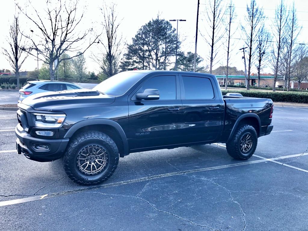

Here's mine. Falcon shocks on level setting with a 1/2" spacer on top of the strut. I am running 285/75/18 Duratracs with .75" spacers in the front and 1" spacers in the rear. No rub whatsoever and it rides like a dream.
Everytime I see this truck I get ideas!
I want to do this same wheel on my Rebel when it gets here. Did you ever change tires? what did you go with?
@jimmy718,
I went with Toyo Open Country AT III, but stayed with same size 275/70/18. Since the wheel is wider at 18x9, the 3 shops I went to all said it would rub without mods. Really liking the tire/wheel combo, very happy with my choice.

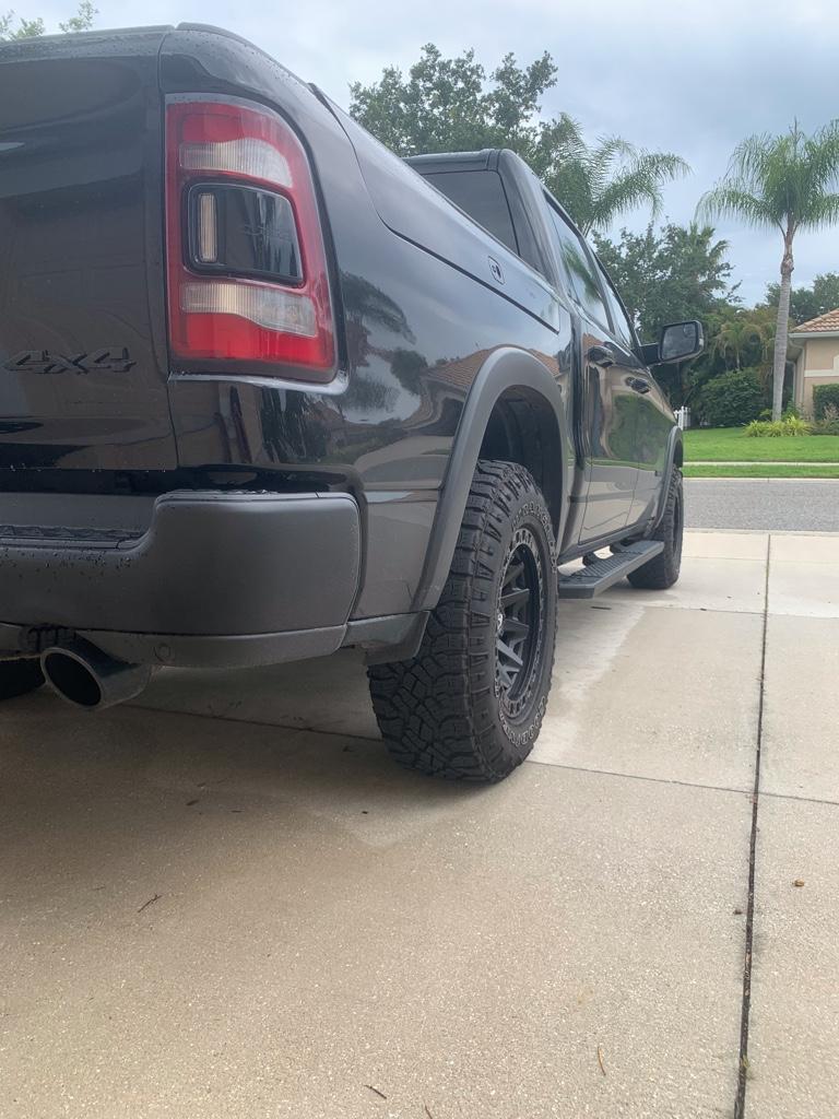

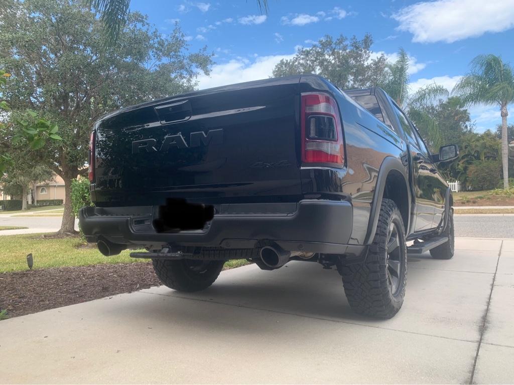

I have a 2019 rebel with air ride and fuel wheels. No lift or level. I fit 295/70 18 Toyo Open Country MTs with room to spare.
