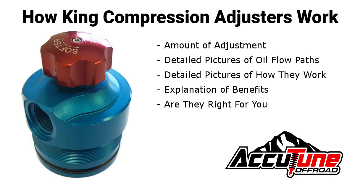

To which, I found out what I thought I would...my Eibach Pro-Truck struts/shocks are adequate on smooth-ish roads still, but the slight jounce and secondary rebound kick, that was small with OEM wheels on large bumps & small washboard-type road cracks/bumps, became more pronounced from the extra 12lbs/corner..I will have to move to Fox PEs or Kings for sure.
The Bridgestone Dueler AT Ascents seem very smooth themselves overall, and handling/cornering didn't diminish at all, but my Eibachs are not up to the task. My only slight complaint with the Ascents (other than the 12lbs) is that they aren't quite as quiet as I'd hoped they'd be..they have a faint, but constant and distinct, typical AT tread sound that is mostly above 45mph..not bad, but I noticed my wife turn the HK volume up 1-2 notches. This are 16/32 ATs compared to OEM 10/32 HTs, so expected.
Calling Don about Thurn Kings today, but back to thinking Fox PEs may be better for me after reading an Accutune article on Kings last night (see link). I'll pick his brain on Thuren's CAs and bars. I do feel the Delrin-bushed "Johnny Joints" would improve fluidity and suspension movement, but want to ask him about any NVH increases or issues. Core4x4 also has complete Rear CA/Bar/Endlink Pkg that looks solid also.
accutuneoffroad.com
