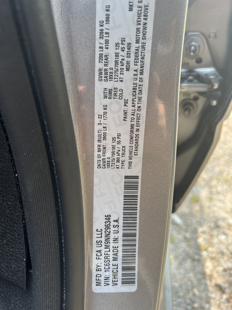

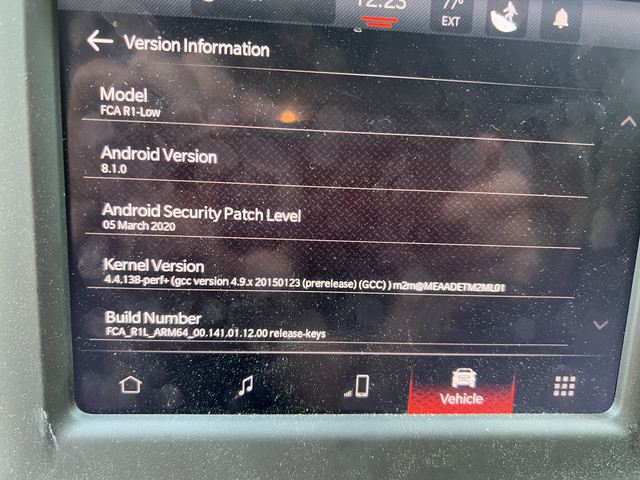

2022 Rebel, 8.4 non nav, non memory seats, build 3-22 purchased 3-24-22, on my 4th hard/factory reset. Uconnect continues to lose presets, backup camera not coming up, changing other settings like dark/light mode at will. Uconnect says I'm up to date, dealer says OTA updates are coming and continue to do resets. I think my next reset will be with a BFH. I am posting a shot of the version screen and VIN sticker. Anything else I can do besides wait for an update? I too would gladly give $500 for uconnect 4.
