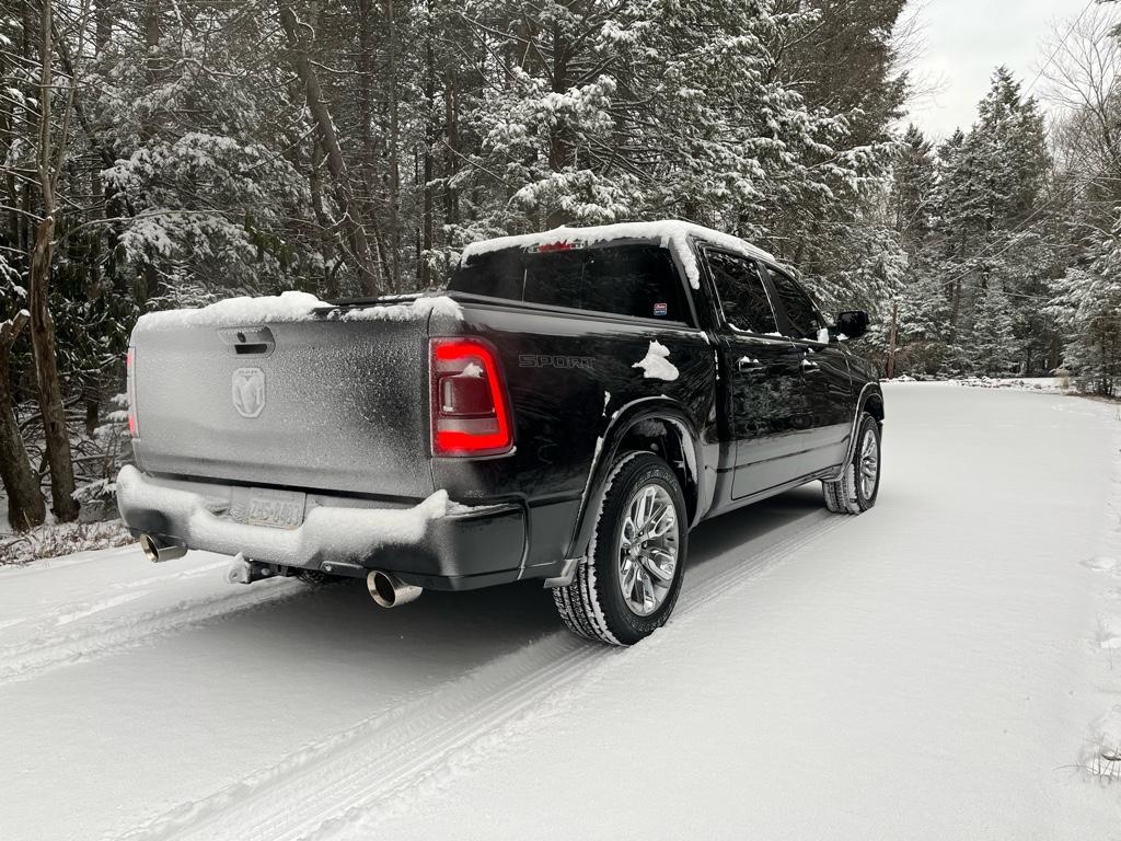

Just a reveiw on the maxtracs 2" lowering springs for my 2022 1500 sport crew cab. The ride is pretty close to stock and install took about an hour. The only problem i see is when i go over medium size bumps on the road it will hit the bumpstops . I'm looking at buying tibren bumpstops to help with towing and it should help bottoming out so hard . I just have to take measurements between my bumpstops and axle, then they can make me a custom set . Has anyone used this kit or similar brand, I believe sumo makes a kit as well.

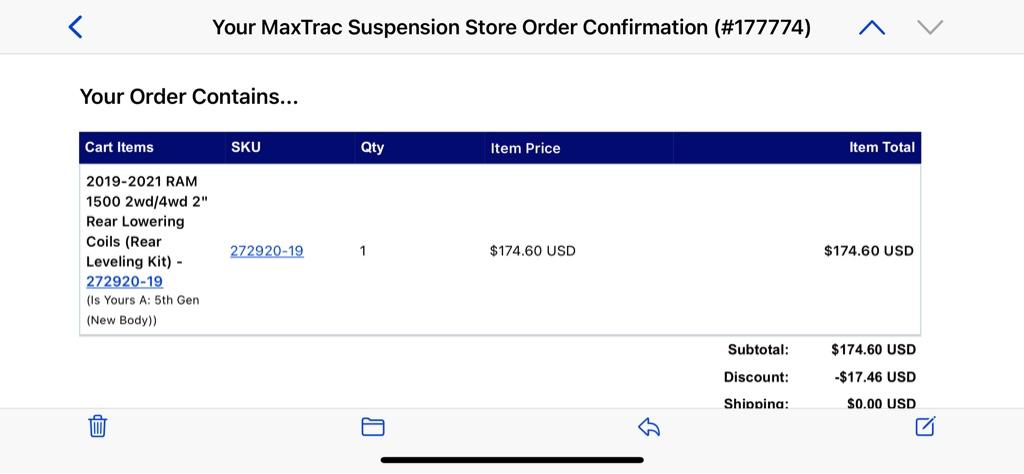

Looks like the website I ordered off of has the wrong description on the part number 272720. There's a screen shot from where I bought them and then from maxtracs. I guess I got the 2wd coils on my 4wd . Do you guys know if there's a difference in spring rate and length ? Nothing seemed wrong during installation.

from everything I have been reading on this subject over the past week, part 272720 will lower more than 272920. which may explain why you are bottoming out and why people with 272920 are not.

New developments! Supposedly 272720 and 272920 is the same coil , they just made another part number so they could separate the years of truck I guess... its in the screen shot .

All this talk about part numbers and wondering whats happening, but has anyone thought to call Maxtrac? I had two great conversations with the head guy there before I bought the lowering springs.
Spanky2
Dec 18, 2021
11
I messaged them in a live chat and attached the conversation in a screen shot in my earlier post ... both part number are the same spring, That's what the sales associate told me .
