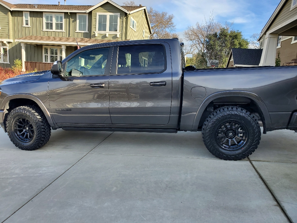

Just got done replacing the suspension on truck. Didn't get the 2.6 advertised by Bilstein with the 6112.
Got about 2 inches on clip 8. Center of axle to fender, I'm now at 24 inches.
I also installed the Icon 1.5 rear spring with the 5160. I have about 1 inch of rake still.
Ride is great, but not sure I'm missing the extra .6 of an inch in the front cause of the eTorque weight?
Just thought others may be interested in the true lift height.

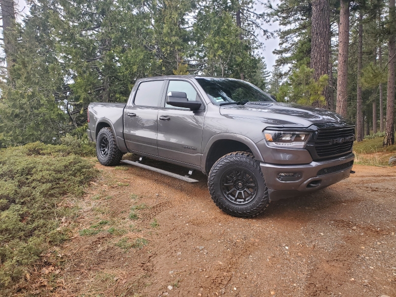

I did not have ORP springs installed. With the springs that came with the 6112's I only got 2" of lift in the front. This was from a non-ORP/non-Rebel starting point. I was able to fit 295/70r18 with no rubbing. I think they are 34.4 inches or so (Geolander G003).
Hope this helps clarify.
