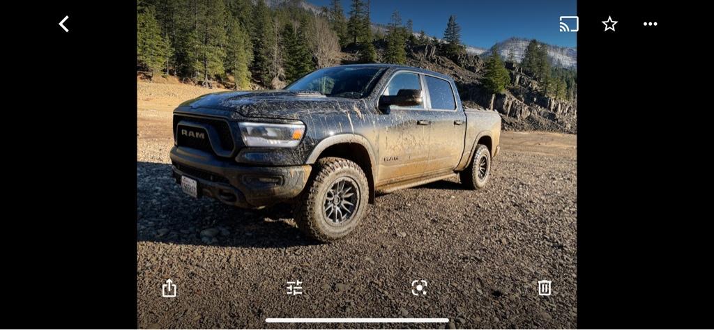

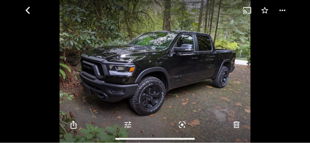

Before
After
Tires are the same in both pictures. I’m also running Clayton springs in the rear for an extra 2”.
U
User_21361
Guest
How do you like the ride? 2.5’ lift or you got the adjustable ones?
I have the extended front coil overs (2”-3”). I got about 2.5” out of them. With the DSC, I am able to adjust the ride quality easily. The ride quality is amazing both on and off road. I added the rear springs because I wanted a little extra lift and higher spring rate to absorb the weight of the gear in my bed. I’m very pleased with the setup.
